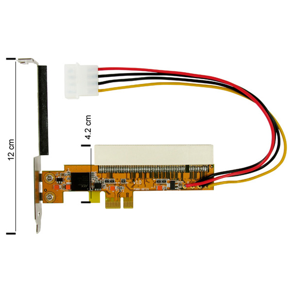

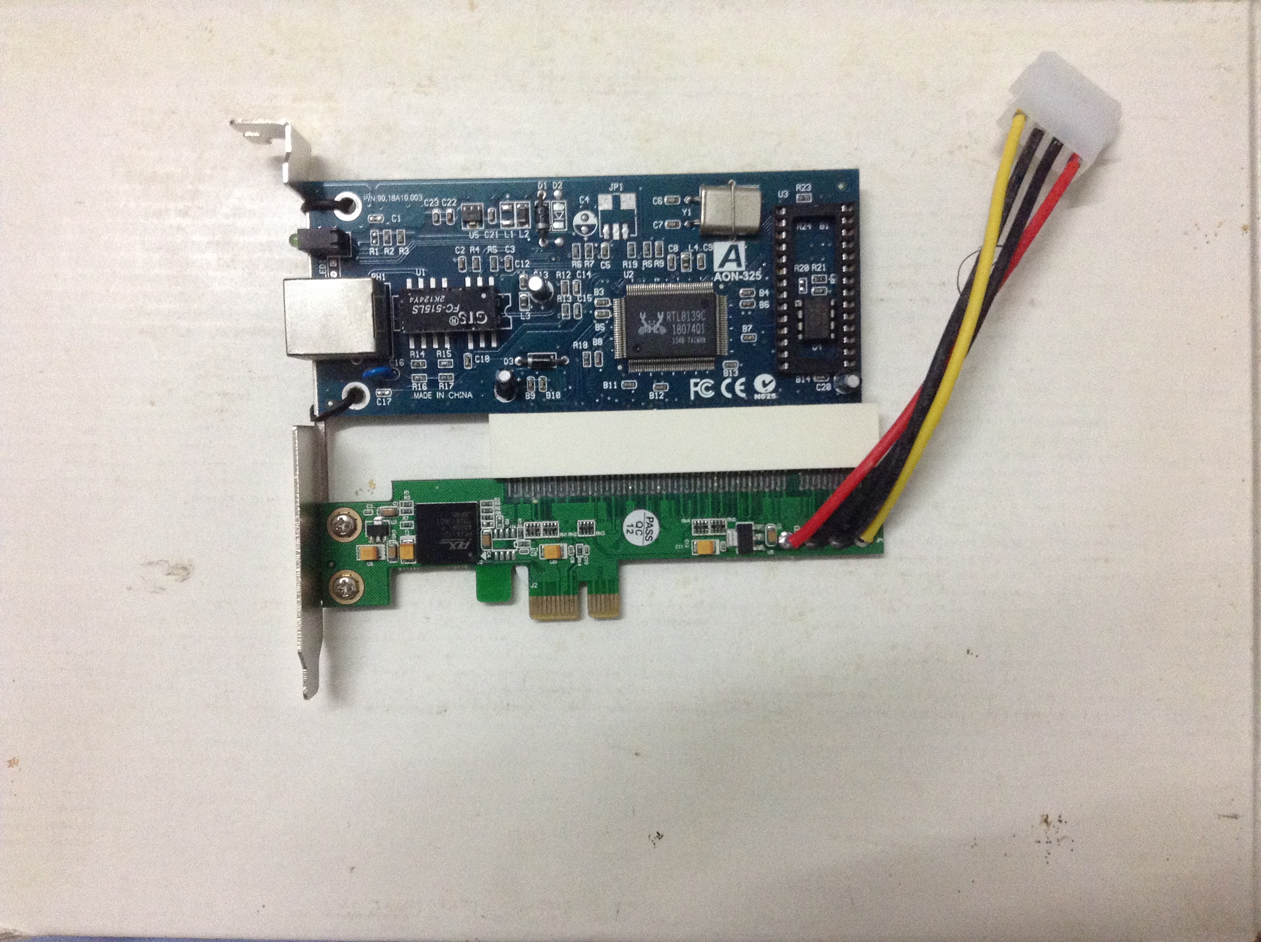

During that period I experimented with a pciex1 to pci adapter .
My Tested Configuration :
PCI 8139 Network card on Pex8112 PCIex1 to PCI adapter .

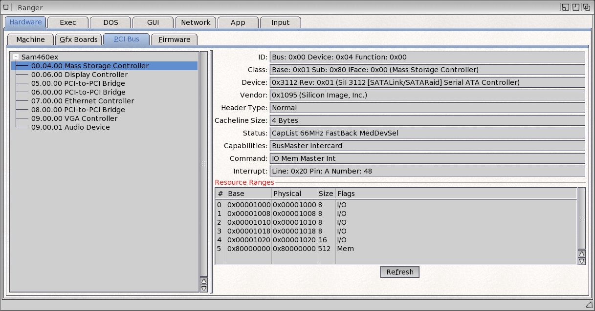

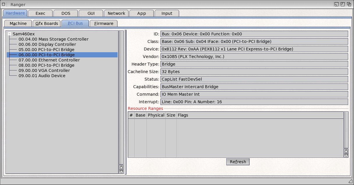

Info from Ranger .
