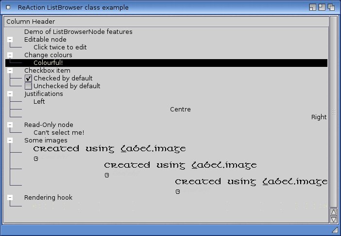

I just modified the LB_Example.c to repeat the label image with left center right justification and it works okay see atached grab.
Do you have specific bit of example code that repeats your issue?
What kind of image object are you adding (small chance the issue might be with the image not the browser).
