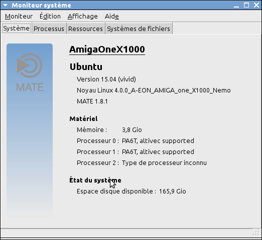

Re: Kernel 4.00 (3.20)
Post by zzd10h »
It works on my 15.04.
Of course, no 3D with my R7-250X but no network problem.
For info, yes, to FAT16-format the CF works ;)
