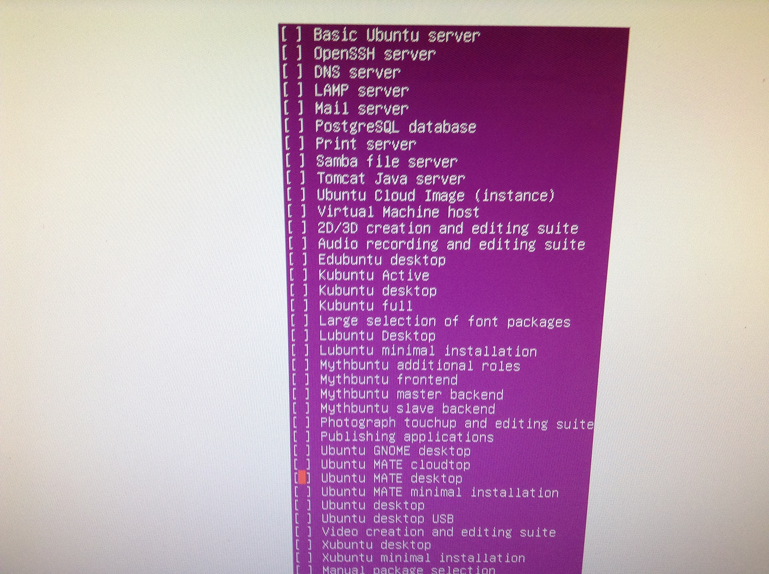

  26. At the software selection screen you will be asked to select which *buntu flavour(s) you would like to install. You can install as many as you like. To install the Ubuntu Server arrow to the “Basic Ubuntu Server” option and press the space bar to mark the option. I recommend to install the OpenSSH Server, too. Now press return to continue.
