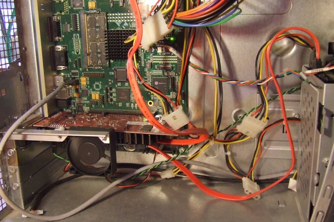

Re: Sam460Ex AOS Display/Boot Problem
My longterm solution for heat issues with graphics card + ability to use dual slot cards .
http://forum.hyperion-entertainment.biz ... 649#p30113
Steady wrote:@thread
FYI, I also just got a SAM460cr and have the SATA card and Radeon right next to each other. I get about 10 minutes use before lockup ... unless I take the side of the case off and lie it down, so definitely a heat issue. That card does seem to get REAL HOT and there is little circulation between the cards.
I will try a fan blowing directly on the card too.
P.S. I'm in Melbourne, Aus so it can get warm here too.
