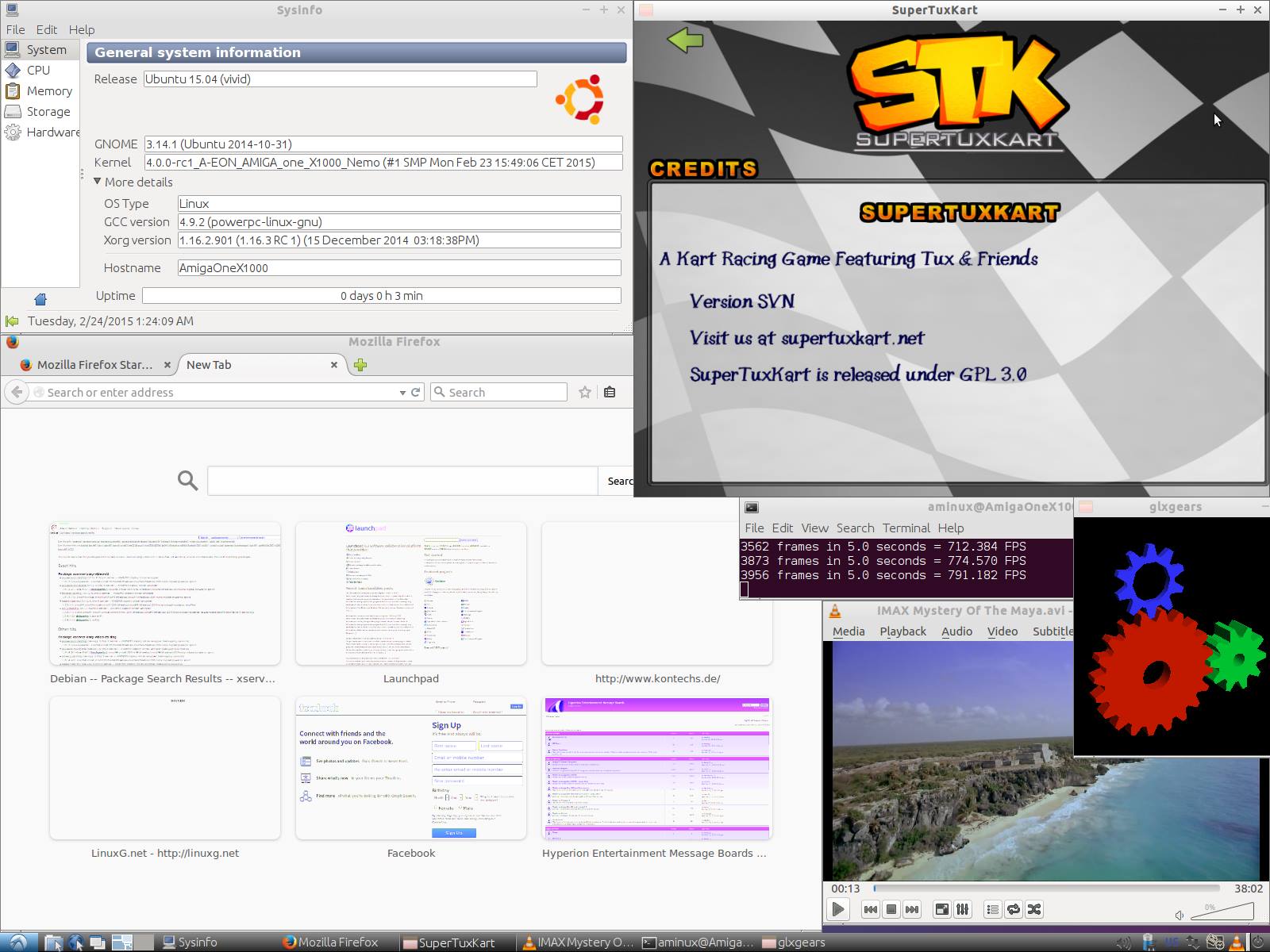

Srtest tested the RC1 of kernel 4.00 with Lubuntu 15.04 yesterday.
Quote Srtest:
Kernel 4.00 RC1 boots ok, although somewhat slower than the blazing 3.19. Here is a desktop pic. You can see the nice colors on GLX gears test, VLC playback and STK while there are wrong colors on the FF start page. Strange isn't it?
@Srtest: Thank you for testing!

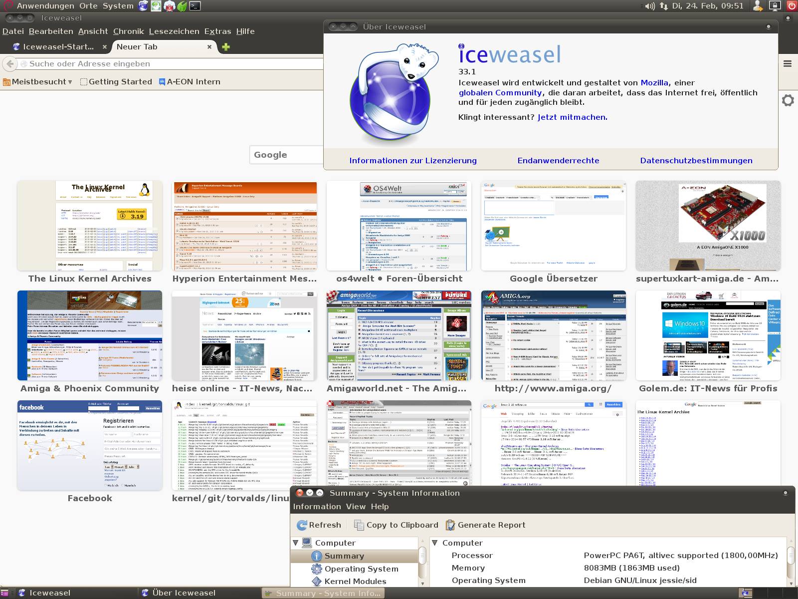

I also test Debian Sid PowerPC. Iceweasel 33.1-1 has right colors. Unfortunately iceweasel 35.0.1-1 is only for amd64 and i386 available currently.
