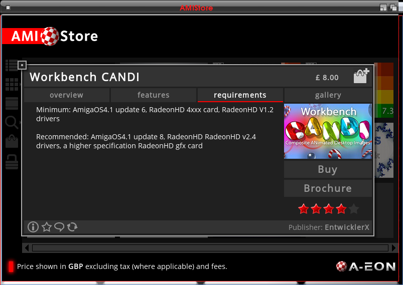

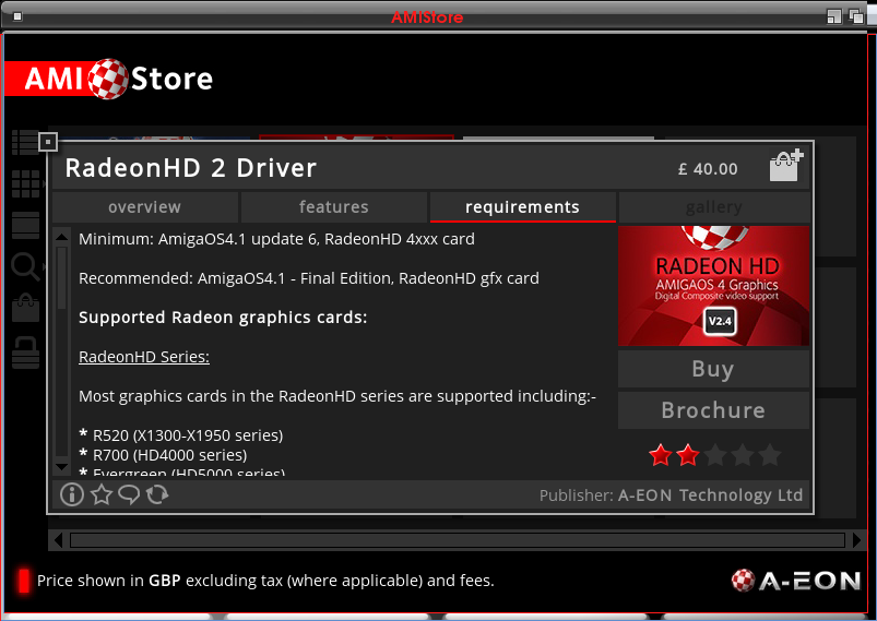

Both of these, definetly the later, but i think both, require Final Edition.The combination of the recent Candi and RadeonHD drivers (2.4)

Re: Right Click Desktop DSI AOS 4.1.6
Can you post your configuration, please?
Candi itself runs fine with AOS 4.1.6 here and it also dont needs RadeonHD 2.4. Context menu also works and EUAE startet too.
Here i run a Sam460, 2gb Ram, RadeonHD5450. What i dont have here is filer in the contextmenu.
Also without candi i have some crashes from contextmenu if i dont have clicked an icon within a workbench window (can not 100% say in which cases). Solved in later versions of contextmenu.
Candi uses compositing effects, look if it is activated in the gui.prefs. Also try the low cpu versions if it runs better, this is aimed for lower cpu and lower gfx cards (like mine 5450).
Please note that in much work is done on the ContextMenu which is available only on AmigaOS 4.1 FE, maybe some bugs are solved there.
The best combination should be ever the latest updates, drivers etc.
