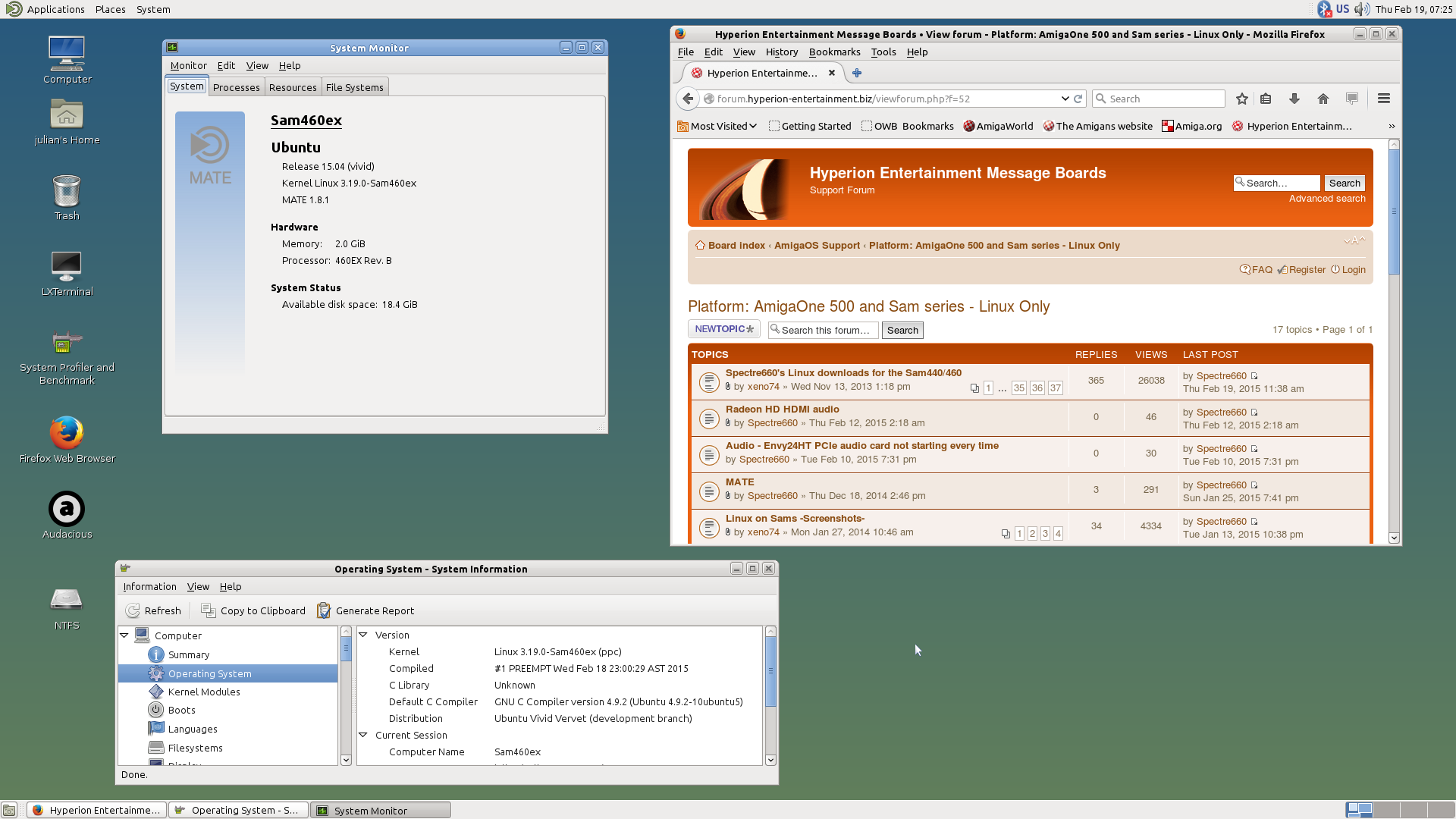

Posts: 1538
Thanks to Michael Ellerman we now have a patch for Sams to have kernel after 3.16 working again .
http://linuxppc.10917.n7.nabble.com/Pro ... 89645.html
Working Sam460ex 3.19 Kernel
https://dl.dropboxusercontent.com/u/542 ... 9.0.tar.gz
Untested Sam440ep 3.19 Kernel
Posts: 11357
Spectre660 wrote:Thanks to Michael Ellerman we now have a patch for Sams to have kernel after 3.16 working again .
Hey Spectre660,
Great work! Well done!!!!!
Downloads:
Kernel 3.19.0 final for the Sam440ep( Flex): Sam440ep-3.19.0.tar.gz

@Spectre660
That's great!
Looking forward to try it out, together with Ubuntu 15.04.
Still I am away from home and Sam460, will let you know as soon as I re-install everything.
Great forum that "linuxppc-dev",
we may end up with a kernel with DRM support!!
Posts: 1538
Indeed.
Hope that we can get the msi interrupts sorted out too.
Might get us closer or even solve the problem with DRM
