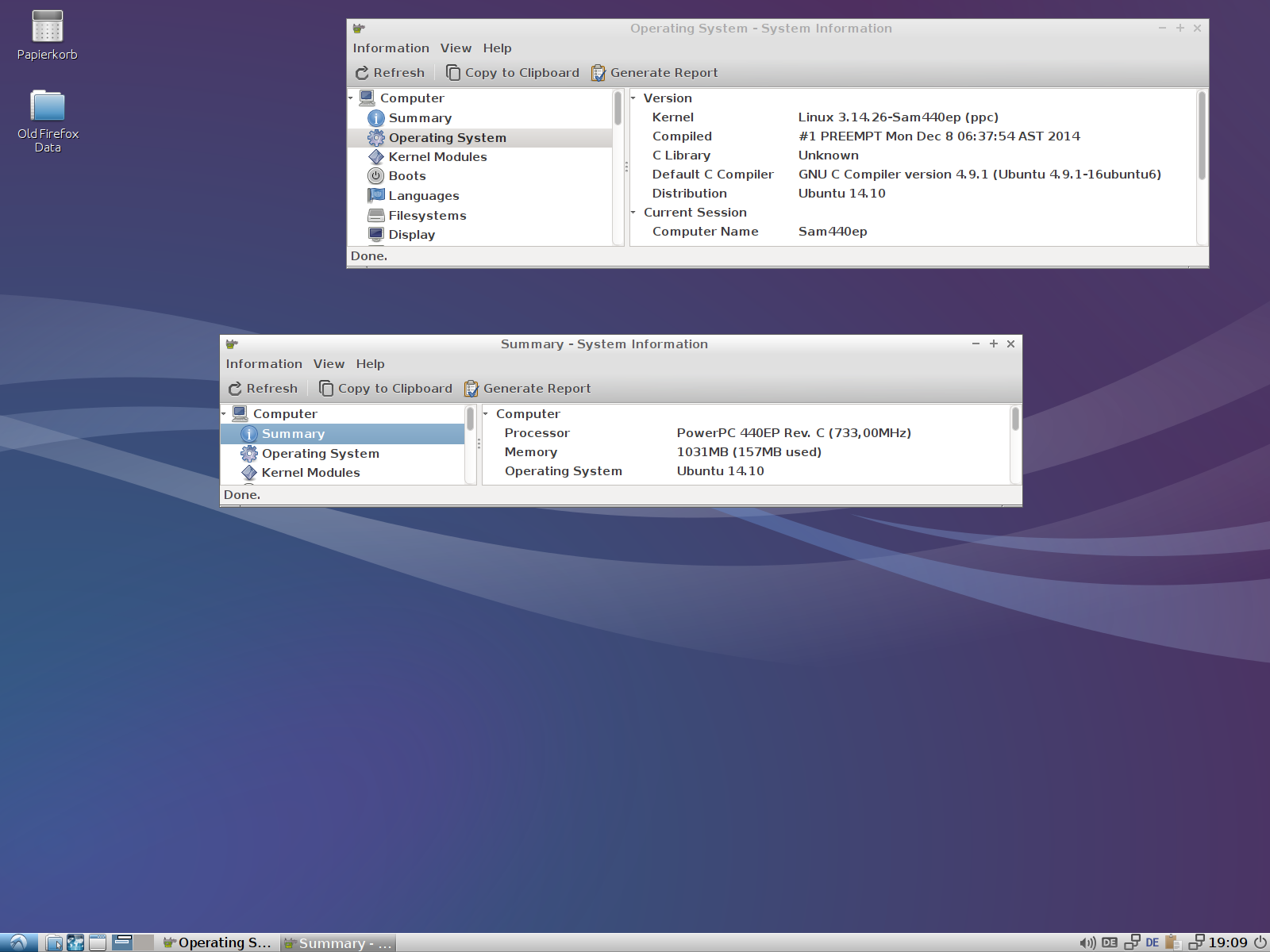

Thank you. :-) I uploaded them.
Kernel 3.14.26 for the Sam440ep( Flex): Sam440ep-3.14.26.tar.gz
Kernel 3.14.26 for the Sam460ex( Lite): Sam460ex-3.14.26.tar.gz
