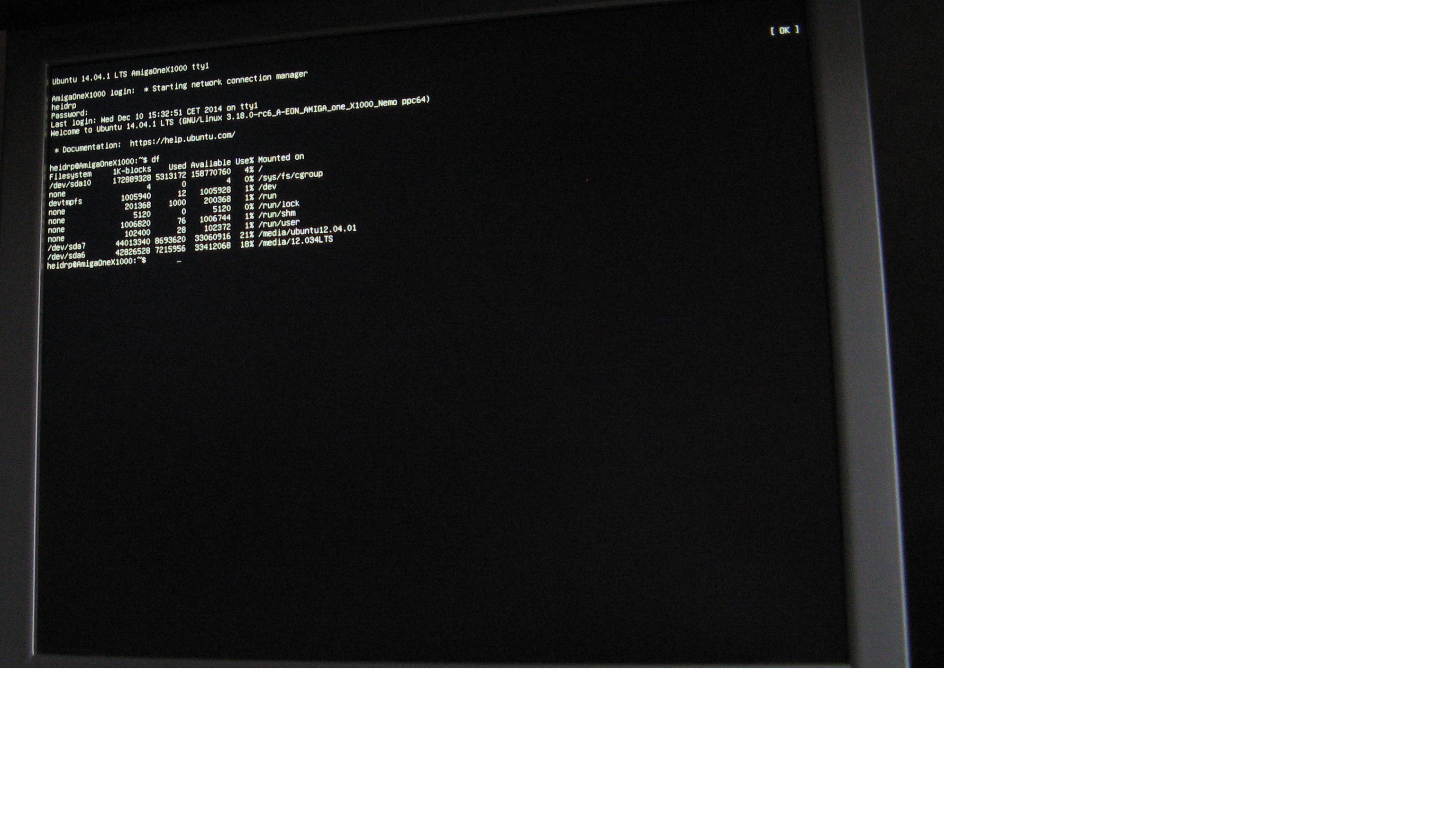

There are not as much drivers included as in Trusty on x86. It seems to me as if there are not all necessary driver included in the kernel 3.17 or 3.18. I have fotographed the screen after booting. see attachement.
Screen shot taken with Foto camera

papaoskar wrote: There are not as much drivers included as in Trusty on x86. It seems to me as if there are not all necessary driver included in the kernel 3.17 or 3.18. I have fotographed the screen after booting. see attachement.
The most of the drivers are included in the kernel itself.
