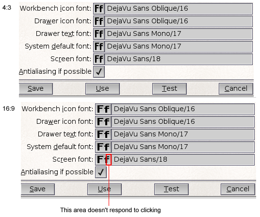

And while we're at it, here's another one that might be related to the screen mode proportions thing:
Using a 16:9 screenmode, the font-chooser-button appears to be stretched and doesn't respond to mouse clicks in the area, that shouldn't be visible anyway. Here's a screenshot to show you what I mean.
Can anybody reproduce this one?

mrupp wrote:Using a 16:9 screenmode, the font-chooser-button appears to be stretched and doesn't respond to mouse clicks in the area, that that shouldn't be visible anyway. Here's a screeshot to show you what I mean.
Yes, I can reproduce it in a 16:10 screenmode (1680x1050) too. But this is not limited to the getfont.gadget only - the gefile.gadget's popup button is also stretched out of proportion. As these are ReAction gadgets, I suggest contacting Rigo and asking him to look into it.
The Rear Window blog
Rigo
Posts: 367
Joined: Mon Jan 17, 2011 9:42 pm
Re: Various smaller bugs
Post by Rigo »
No need, I see everything :)
