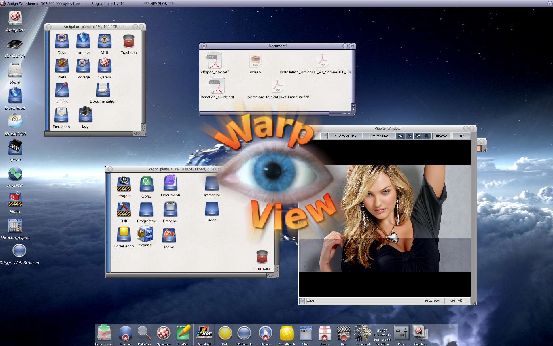

Ok, purchased VGA cable and setted resolution to 1920x1200. Works fine, but seems to me that the fonts and the screen is not so clear, I attached a png file to this post, some desktop images that I look fine on linux in amiga seems corrupted (why?). Look at the girl picture in right corner.
(203.67 KiB) Downloaded 1633 times

Fixing fonts size with type manager and saving it solved the problem.
Sorry for time wasting and thanks.
Now looks more clean ;)
