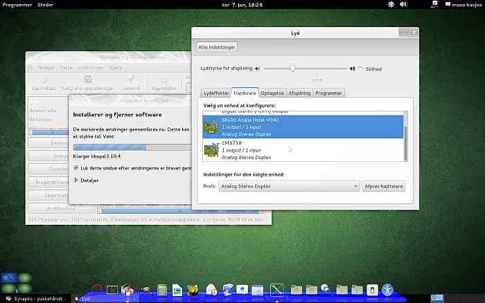

Re: X1k No on-board sound. (Linux)
My last installation of debian wheezy as I did in a try to get compiz ( i got it) also gave me onboard sound

musa wrote:My last installation of debian wheezy as I did in a try to get compiz ( i got it) also gave me onboard sound
Good to know. Thanks.
