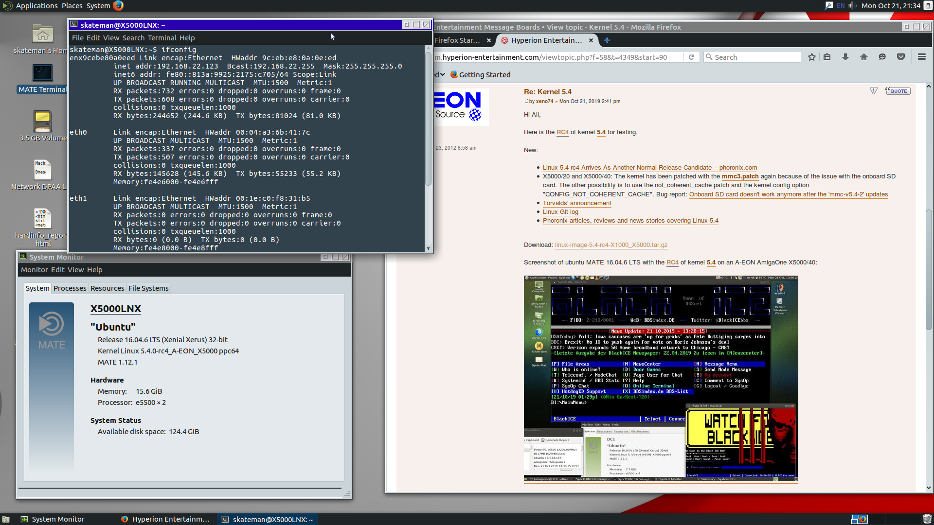

Skateman wrote:Christian could you try this?
Make sure the ethernet cable of the onboard X5000 ethernet adapter is unplugged.
sudo ifconfig eht0 down (enter)
sudo ifconfig eht0 up (enter)
Now plug in a cable in the onboard X5000 ethernet adapter.
The adapter gets an Ip adress through DHCP and see if it works.
I tested it today. Unfortunately I can't activate eth0 after sudo ifconfig eth0 down.
sudo ifconfig eth0 up
Error message:
SIOCSIFFLAGS: No such device

Here is the RC4 of kernel 5.4 for testing.
Download: linux-image-5.4-rc4-X1000_X5000.tar.gz
Screenshot of ubuntu MATE 16.04.6 LTS with the RC4 of kernel 5.4 on an A-EON AmigaOne X5000/40:

Do you not have an Eth0 when using ifconfig ?
Posts: 972
Re: Kernel 5.4
Kernel 5.4 RC4 up and running on the AmigaOne X5000
Big picture http://www.skateman.nl/wp-content/uploa ... 213417.png
Christian see the output of my sudo ifconfig. there is an Eth0 and Eth1 (both X5000 onboard adapters)
Posts: 11180
Re: Kernel 5.4
Many thanks for testing the RC4!
I have the same ifconfig output but after deactivating (down) I can’t activate the interfaces anymore.

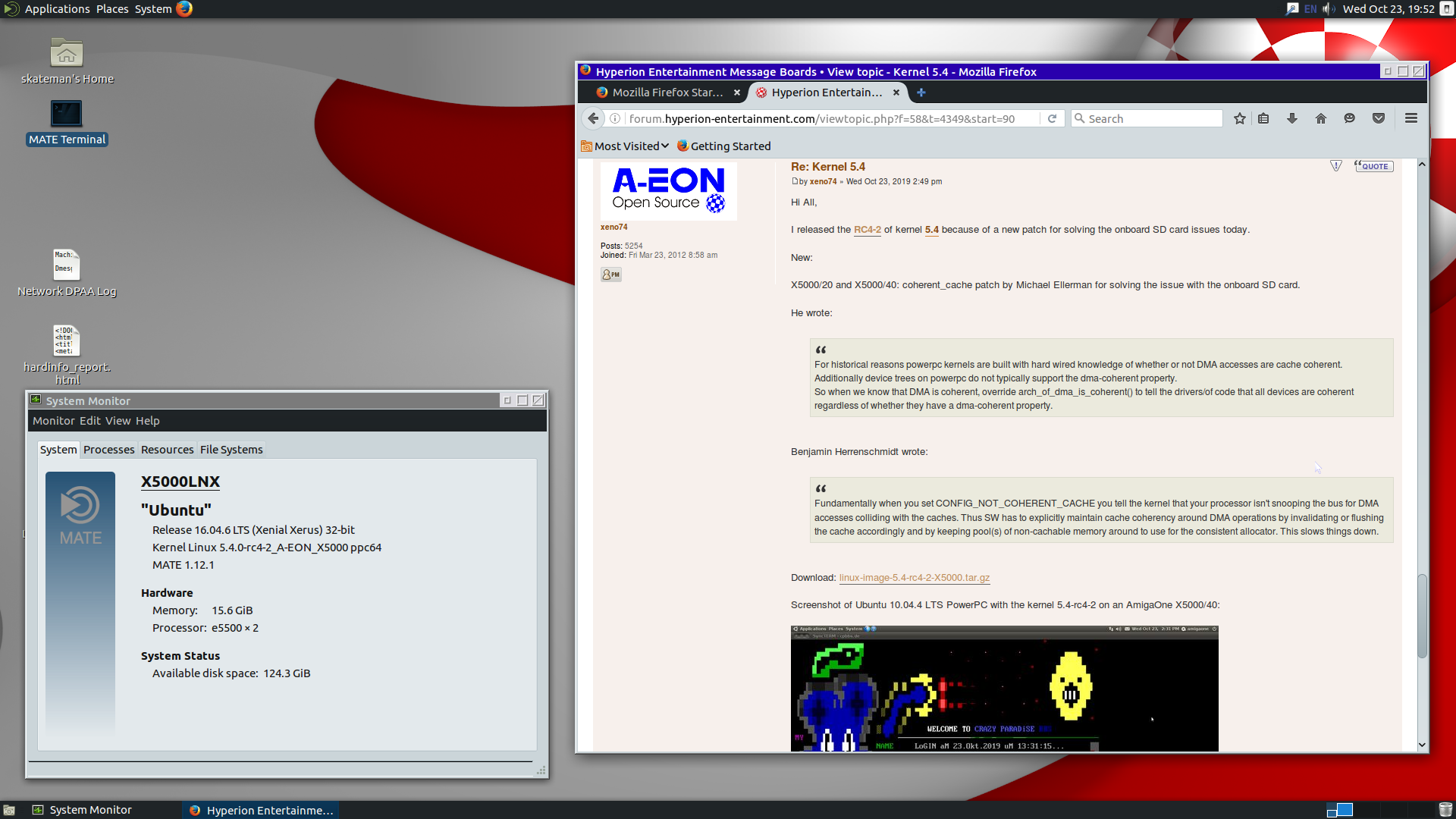

Posts: 11180
Re: Kernel 5.4
I released the RC4-2 of kernel 5.4 because of a new patch for solving the onboard SD card issues today.
X5000/20 and X5000/40: coherent_cache patch by Michael Ellerman for solving the issue with the onboard SD card.

Screenshot of Ubuntu 10.04.4 LTS PowerPC with the kernel 5.4-rc4-2 on an AmigaOne X5000/40:
Posts: 972
Re: Kernel 5.4
Kernel 5.4 RC4-2 up and running on my AmigaOne X5000.
Big picture http://www.skateman.nl/wp-content/uploa ... 195233.png
