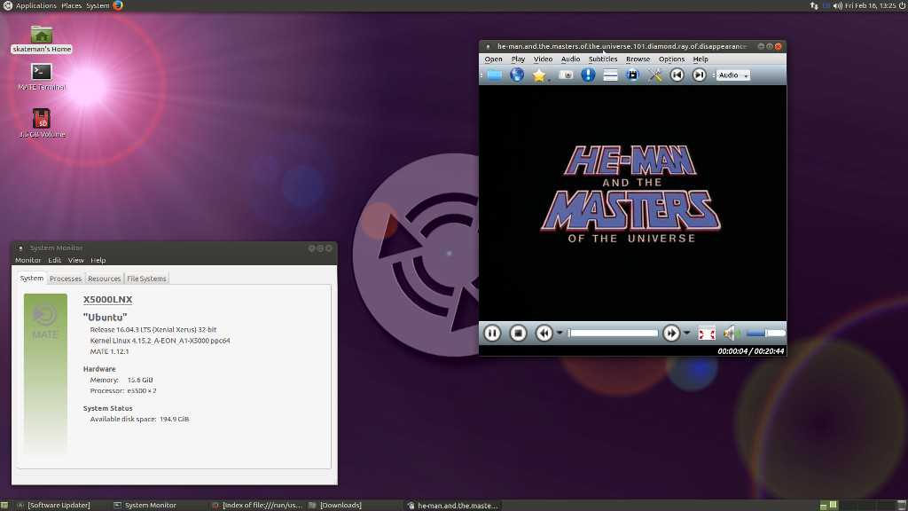

15-2 running fine on my X5000 :-

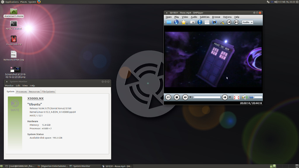

Screenshot of Debian Buster/Sid PPC64 with the stable kernel 4.15.3 and with the new MATE 1.20.0 on an AmigaOne X5000:

15.3 up and running....

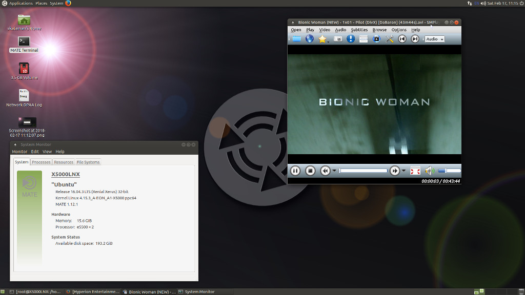

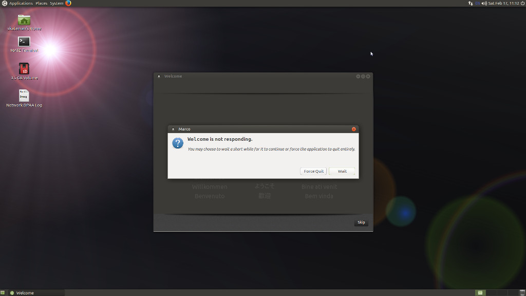

With the unimplemented math version..
When loading the welcome screen an error occurs.
But overall no real noticeable differences yet..
