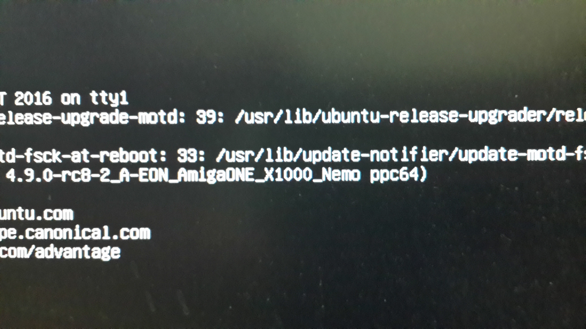

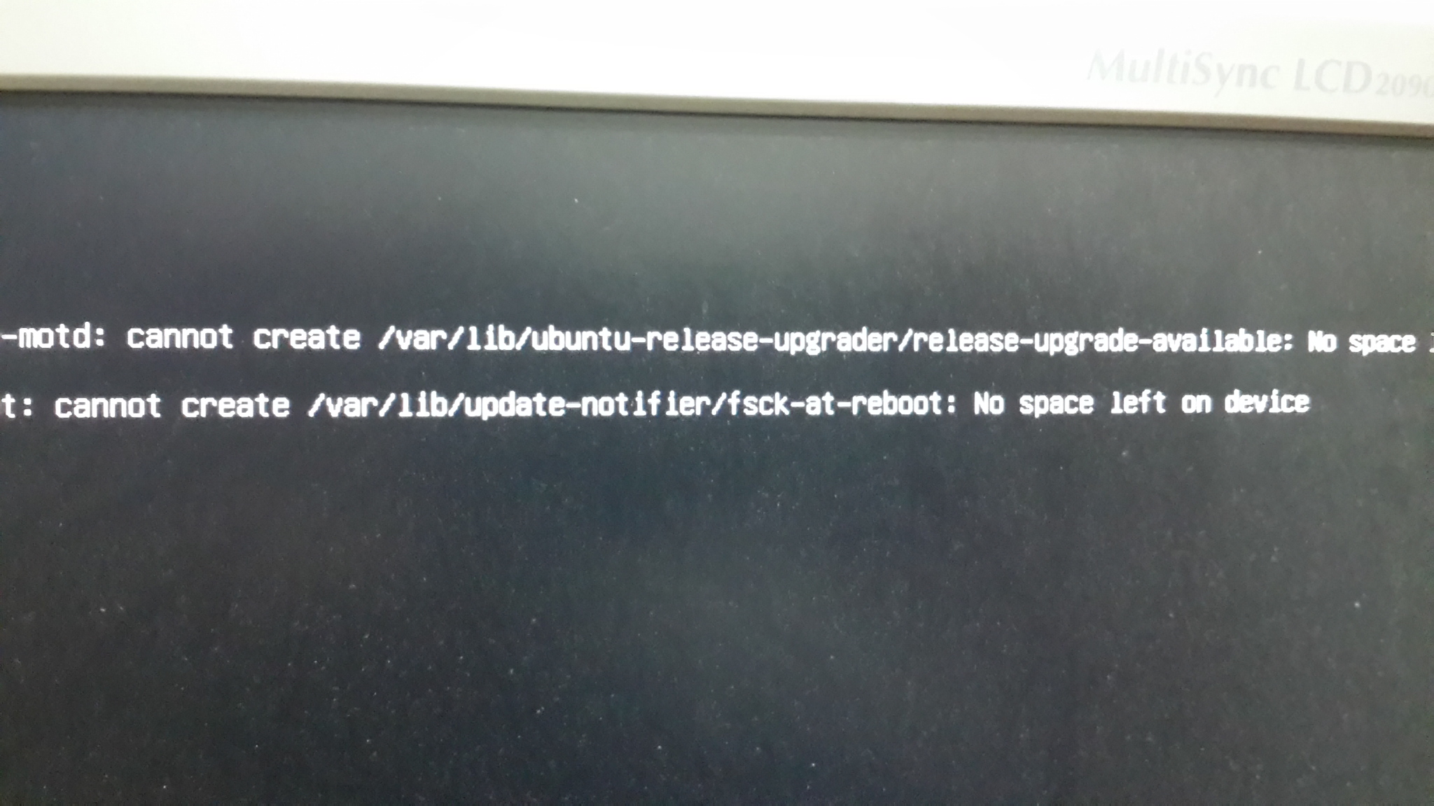

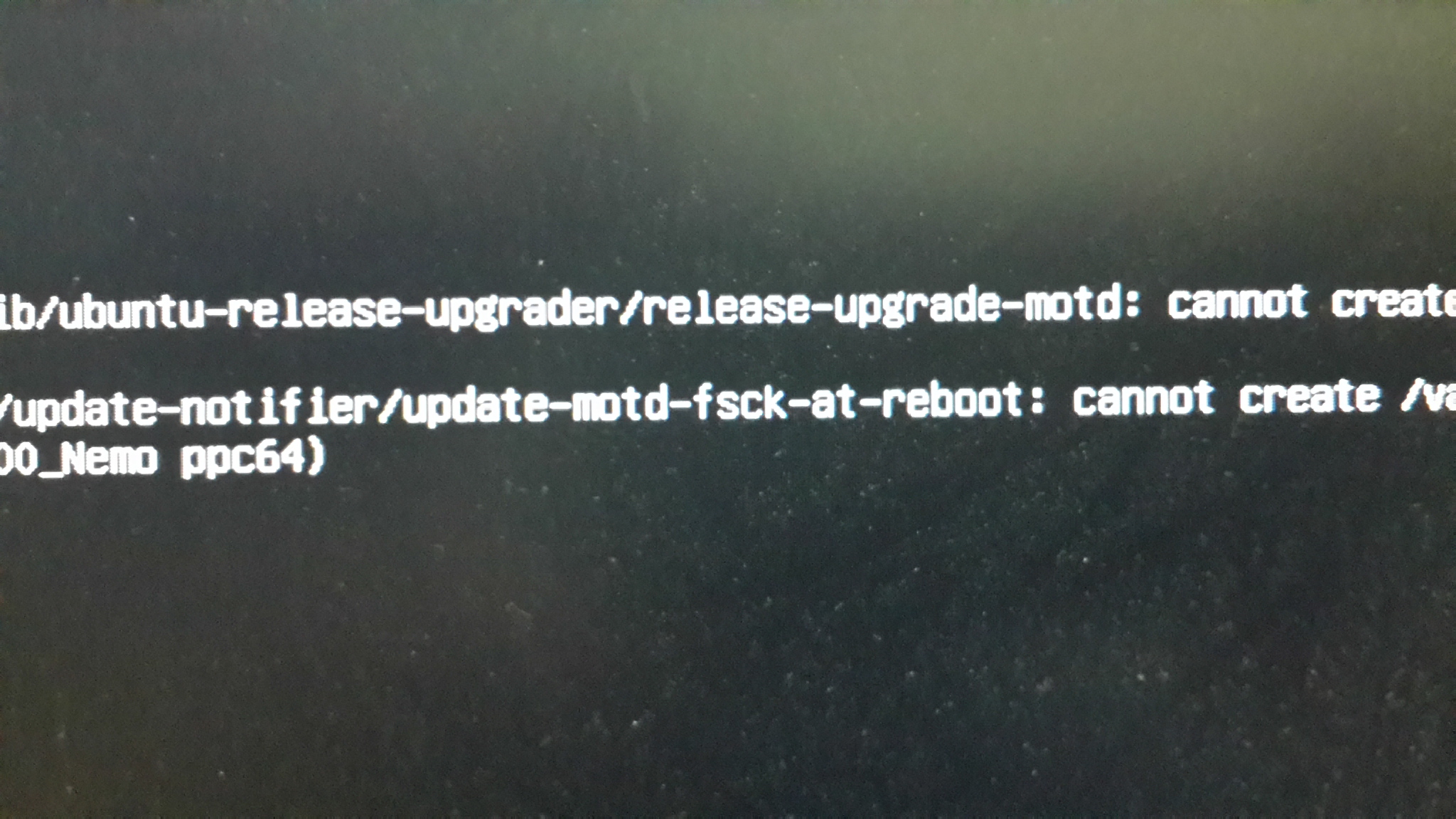

Unfortunately it gets stuck at logon while declaring it has no more room left to create whatever it needs to create. I guess they once again broke btrfs after it worked very well. Either that or incompatibilites with ubuntu and fs2k. I'm adding pics that try to capture it from the console. Something about ubuntu upgrader/updater (latest version on latest 16.10). Booting with 4.7 doesn't cause it and it logges-on without an issue.

Srtest wrote:It boots!! thanks!
Hi Srtest,
Many thanks for testing the RC8-2. :-) Do you have an ext4 partition for testing the RC8-2? If not, could you please boot the ubuntu MATE 16.04.1 LTS Live DVD with the RC8-2?
