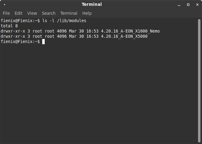

Please post the output of ls -l /lib/modules.

Hi sundown,sundown wrote:
I think you should copy only your X1000/X5000 version of modules.
I.e. copy subfolder
linux-image-5.1-rc6-X1000_X5000/X1000/kernel_modules/5.1.0-rc6_A-EON_X1000_Nemo to /lib/modules/
It should look like:
$ls /lib/modules/
Thanks for that info, thought thats the way it should be, but wasn't 100% sure.sailorMH wrote:Hi sundown,sundown wrote:
I.e. copy subfolder
It should look like:the name of folder in /lib/modules should exact match your kernel version ( $uname -a )Code: Select all
$ls /lib/modules/ 5.1.0-rc6_A-EON_X1000_Nemo

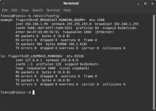

Please post the output of /sbin/ifconfig.

I think that that ifconfig does not exist in fienix until after upgrade I also have no network due to a conflict between dummy.device and my network card.
Musa
Musa

I also see that you have dummy.device as your network device and that was the same error I had.
I remove the dummy device with ifconfig dummy0 down;
rmmod dummy;
The following command changes the network interface named “eth0” to use the IP address 102.168.0.1, and assigns the subnet mask 255.255.255.0:
sudo ifconfig eth0 192.168.0.1 netmask 255.255.255.0 (use your on adress)
good luck
