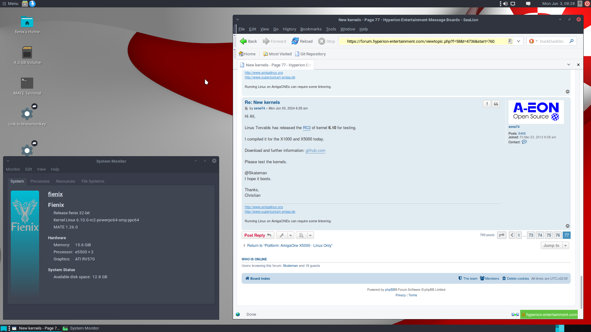

FYI because of the Xorg issue:
Michael Ellerman wrote: That is presumably because of this:
https://lore.kernel.org/all/0da9785e-ba ... ernel.org/
cheers
I was able to revert it.
git revert 8c467f3300591a206fa8dcc6988d768910799872
Link: VT: Use macros to define ioctls
Xorg works again if I revert this commit. I uploaded a new uImage-6.10 for testing.
Download: uImage-6.10

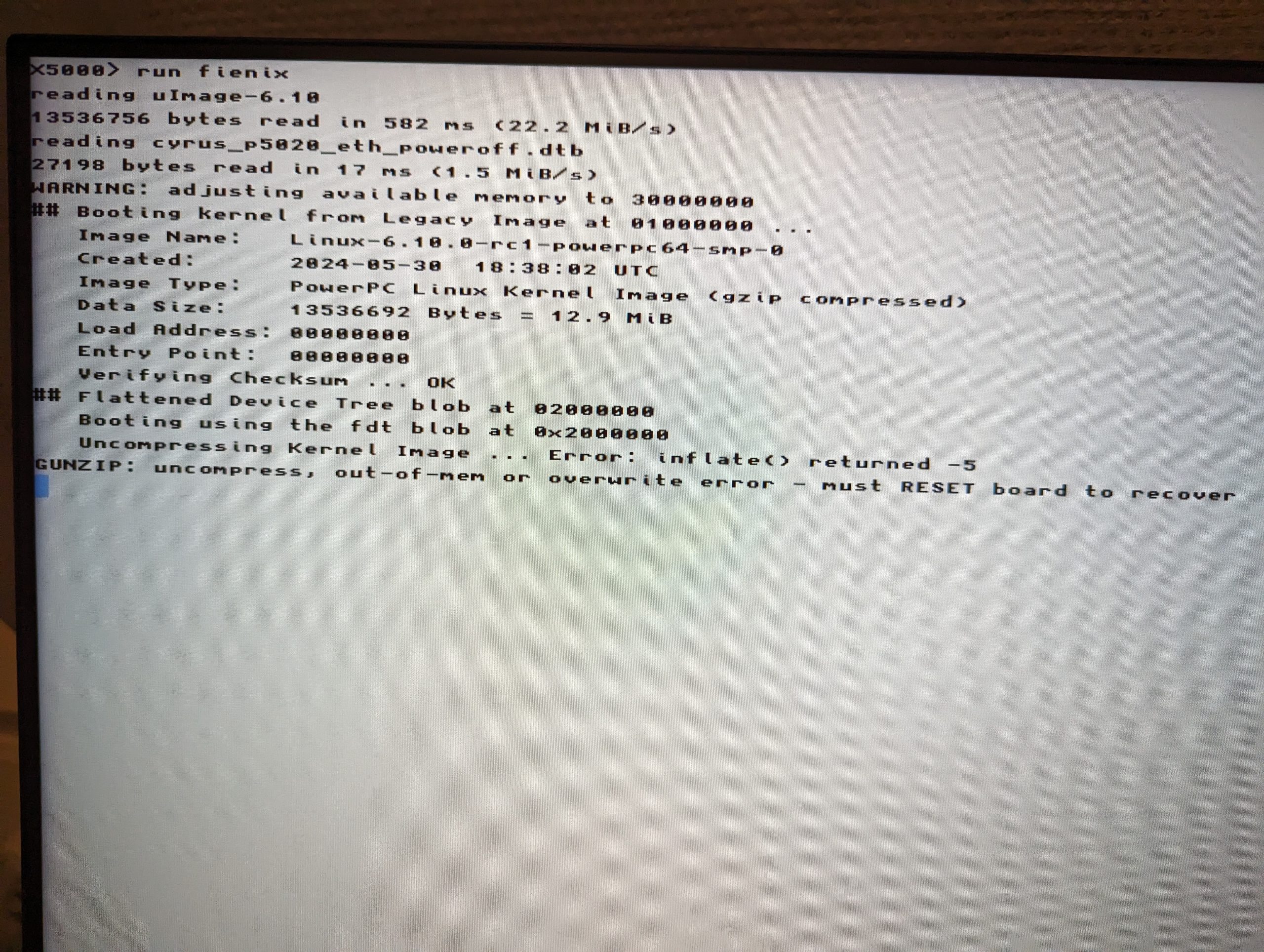

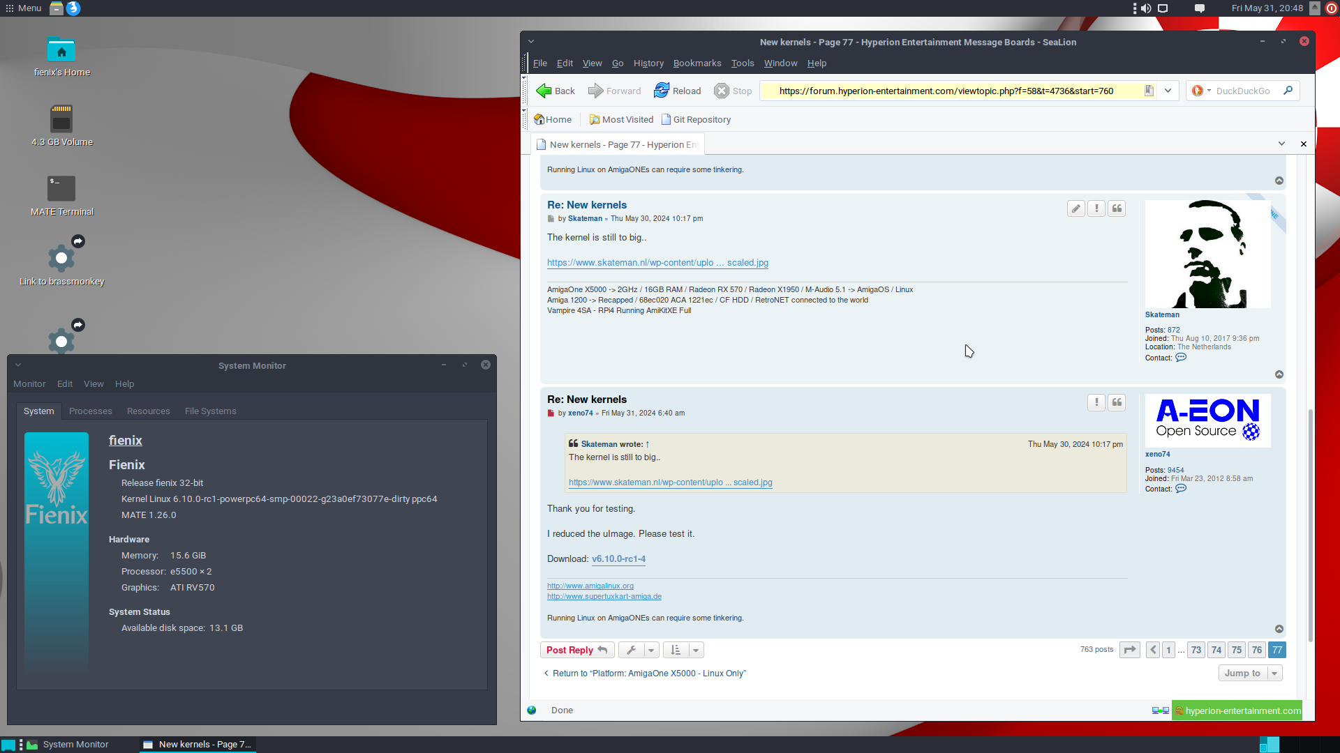

Skateman wrote: Thu May 30, 2024 10:17 pm The kernel is still to big..
https://www.skateman.nl/wp-content/uplo ... scaled.jpg
Thank you for testing.
I reduced the uImage. Please test it.
Download: v6.10.0-rc1-4
Posts: 968
The resized kernel is working fine on my AmigaOne X5000
No issues found!
Big picture https://www.skateman.nl/wp-content/uplo ... -48-33.png

xeno74 wrote: Fri May 31, 2024 6:40 am
I reduced the X5000 Linux kernel last week. That means, I removed some drivers. If your hardware doesn't work anymore then please report it. I will add the driver as soon as possible.

Linus Torvalds has released the RC2 of kernel 6.10 for testing.
I compiled it for the X1000 and X5000 today.
@Skateman
I hope it boots.
Posts: 968
Kernel 6.10 RC2 is running fine on my AmigaOne X5000
Big picture https://www.skateman.nl/wp-content/uplo ... -28-32.png
