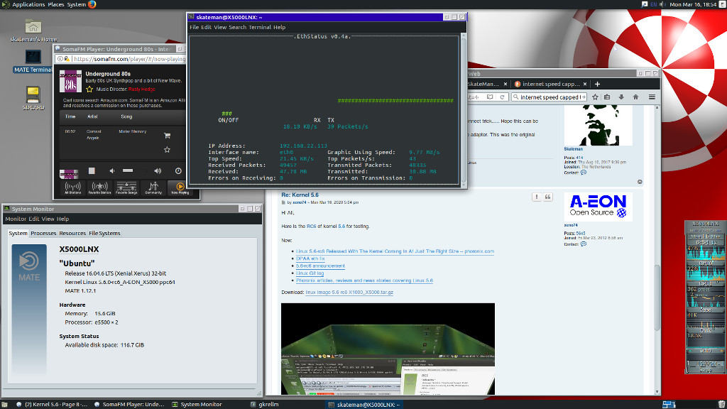

Re: Kernel 5.6
Kernel 5.6 RC6 is running fine on the AmigaOne X5000.
Big picture http://www.skateman.nl/wp-content/uploa ... 185412.png
Still very happy with working DPAA network adapter!
