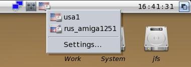

@all
Javier right, i tested right now his latest beta of switcher : and base are done. I.e. for first keymap it read intput.prefs, and for second keymap with choice it in settings (or also can use tooltype by default). Then, we press lbm on dock image (which are rendered flag of the keymap from input.prefs by default), it spawn 2 flags related to choicen keymaps, choice any of them and keymap switch happens. So it do all the basics already, now just need some love and polishing of actual rendering in dock, making menus looks good, and then if Javier will not bored at this moment adding of commodity broker + to settings one more option to set key-combo for switch , and we are ready

Re: we need inbuild keymap switcher as commoditie
@all
Javier to president:
- Attachments
- keymap_switcher_almost_done.jpg (9.16 KiB) Viewed 14473 times
Sort of
I have a freeze if I drag&drop an icon over docky/flag_icon ¿:-P.
Tried to use bitmap.image to load the image flag (shows pink rectangle instead of flag image):
instead of (see image flag OK):
PS: apart obious doesn't/does work
It works, but as soon as I drag&drop an icon over its docky -> system freezes.zzd10h wrote:I don't understand,
With the code that I sent you, you still have pink rectangle instead of flags ?
It worked well for me (and it seems for Kas1e, too).
Seems if I havel 'LoadImage()' in 'DOCKYSET_RedrawNow' is the culptrit, trying to find a better "place" to load flag
EDIT: moved to' _Screen' and not disposing image until quit/release seems solves this freeze problem!!!
