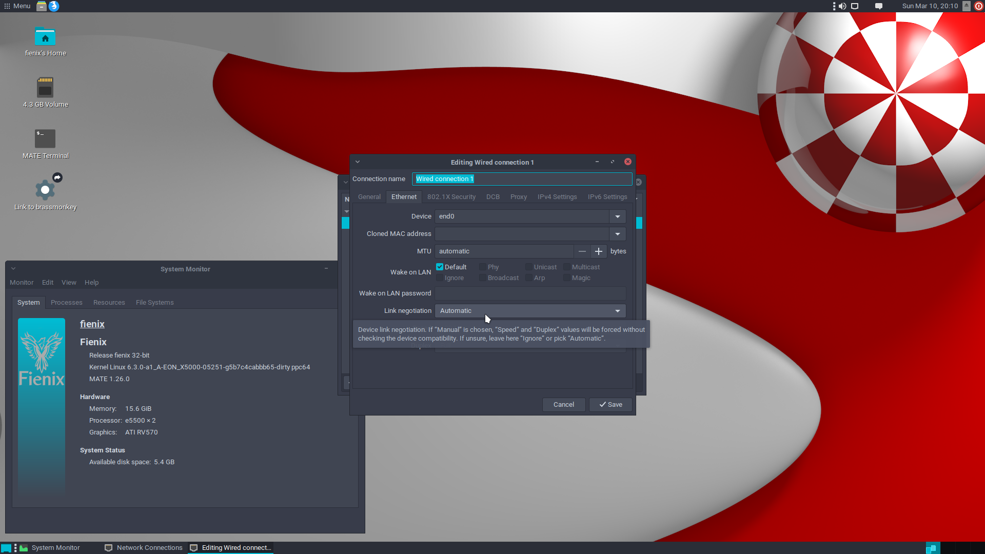

kernel 6.8.0 RC5 up and running on my AmigaOne X5000
Big picture https://www.skateman.nl/wp-content/uplo ... -25-01.png

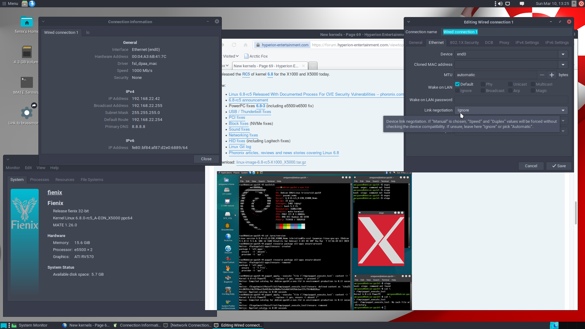

I have tried many older kernels but the auto negotiation issue seems to be around for a long time already. 5.10 final was fine but 6.7 final had the same issue. Anyway...
The fix was easy! Just IGNORE the auto negotiation speed settings and all kernels will accept this.

Posts: 968
Kernel 6.3 Alpha 1 does NOT suffer from the autonegotiation issue. All working fine with negotiation set to Automatic
Big picture https://www.skateman.nl/wp-content/uplo ... -10-29.png

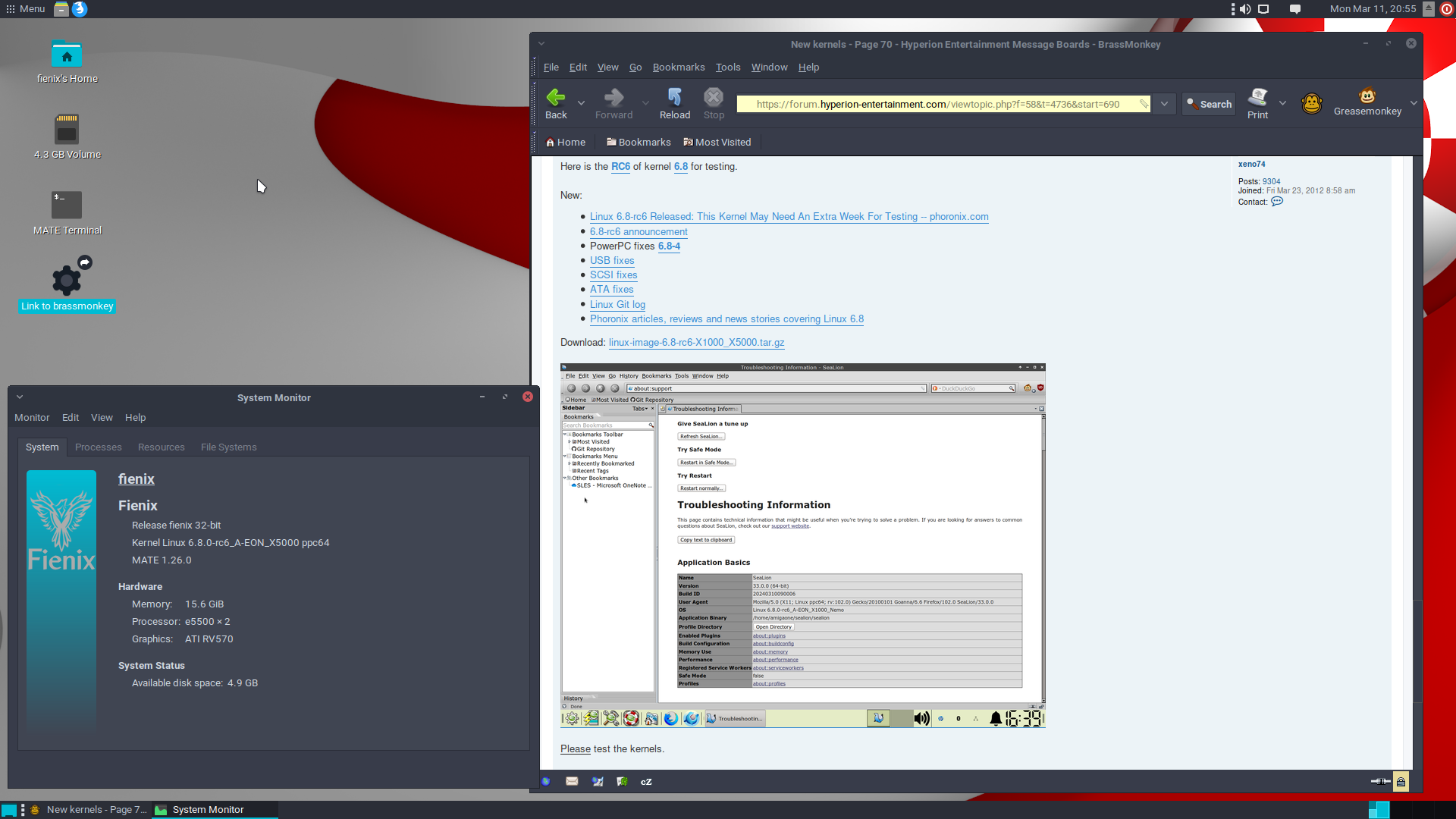

Kernel 6.8 RC8 up and running on my AmigaOne X5000
Big picture https://www.skateman.nl/wp-content/uplo ... -55-18.png

Posts: 968
Hi Cristian,
I am afraid i made a mistake after testing so many different kernels...
Final kernel 6.2 does not seem to have issues and 6.3 Alpha1 does have the negotiation issues. After testing again yesterday evening.
So i would suggest that the issue is in between Final kernel 6.2 and Alpha 1 of 6.3...
For now the issue is always solved when you set the negotiation on IGNORE or MANUAL (by setting the speed and duplex)
I will put some extra time in testing both 6.2 final and 6.3 alpha 1 just to be sure.
What happens when you set the negotiation to IGNORE and use the DPAA adapter ?
