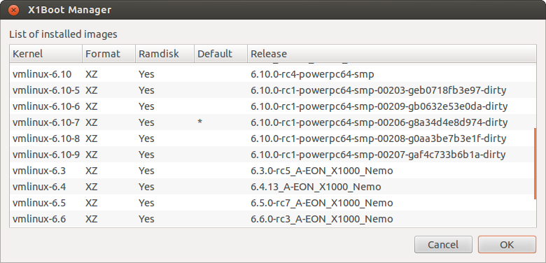

So I've tested up to the vmlinux-6.10-9 kernel. I get the same lightrdm error. Here is a little more info on it:
x lightdm.service - Light Display Manager
     Loaded: loaded (/lib/systemd/system/lightdm.service; enabled; preset: enabled)
     Active: failed (Result: exit-code) since Tue 2024-06-25 03:16:52 AEST; 2min 55s ago
   Duration: 60ms
       Docs: man:lightdm(1)
    Process: 2362 ExecStart=/usr/sbin/lightdm (code=exited, status=1/FAILURE)
   Main PID: 2362 (code=exited, status=1/FAILURE)
        CPU: 98ms
Jun 25 03:16:52 fienix systemd[1]: lightdm.service: Scheduled restart job, restart counter is at 5.
Jun 25 03:16:52 fienix systemd[1]: Stopped lightdm.service - Light Display Manager.
Jun 25 03:16:52 fienix systemd[1]: lightdm.service: Start request repeated too quickly.
Jun 25 03:16:52 fienix systemd[1]: lightdm.service: Failed with result 'exit-code'.
Jun 25 03:16:52 fienix systemd[1]: Failed to start lightdm.service - Light Display Manager.
Jun 25 03:16:52 fienix systemd[1]: lightdm.service: Triggering OnFailure= dependencies.
Jun 25 03:16:52 fienix systemd[1]: lightdm.service: Failed to enqueue OnFailure= job, ignoring: Unit plymouth-quit.service not found.
So what I wonder is what happened to RC5 and beyond? All these kernels are RC1 releases. Without specific modules won't they fail?

This is an old bug. It was solved 4 weeks ago. Link: Xorg issue because of using macros to define ioctls
You see this bug again because of bisecting.
Could you also please test the kernel vmlinux-6.10-10?
