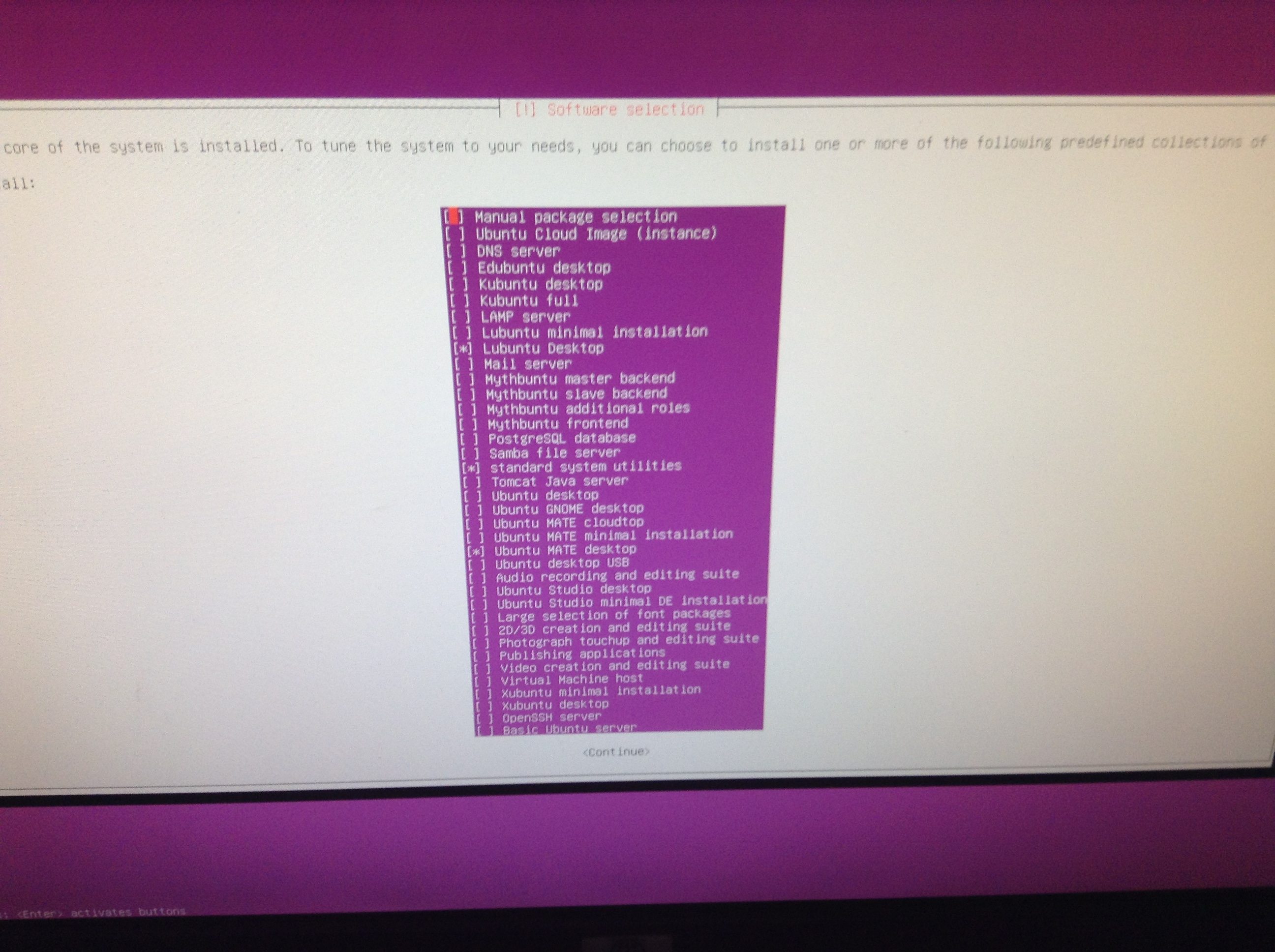

When Installing Lubuntu 16.04 select both Lubuntu Desktop and Ubuntu Mate Desktop.
