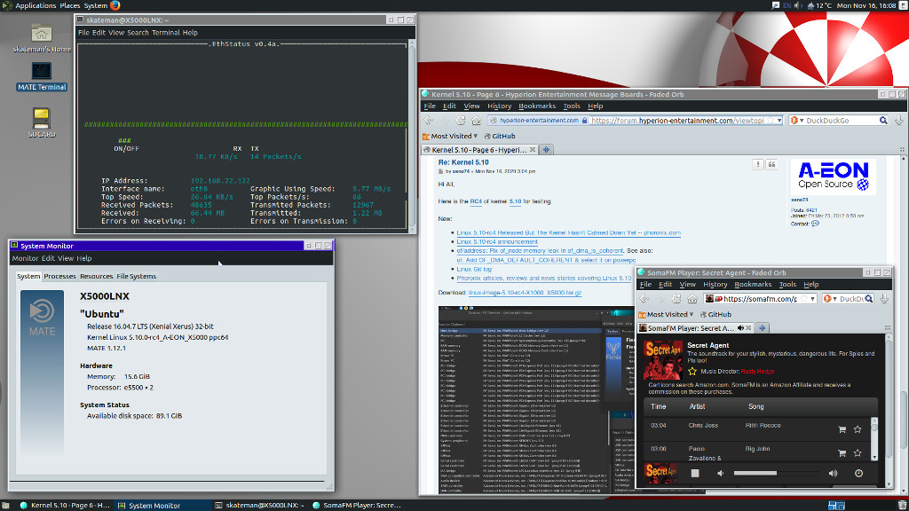

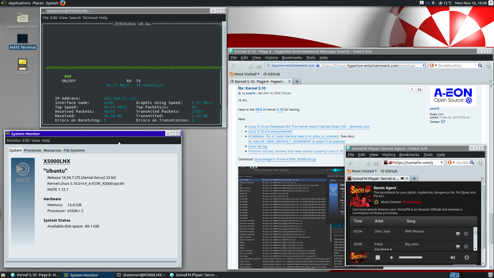

Posts: 972
Re: Kernel 5.10
Kernel 5.10 RC4 is running fine on my AmigaOne X5000
Big picture http://www.skateman.nl/wp-content/uploa ... 160801.png
Posts: 11172
Re: Kernel 5.10
Skateman wrote: Mon Nov 16, 2020 3:10 pm Kernel 5.10 RC4 is running fine on my AmigaOne X5000
Thank you for testing the RC4! :-)
