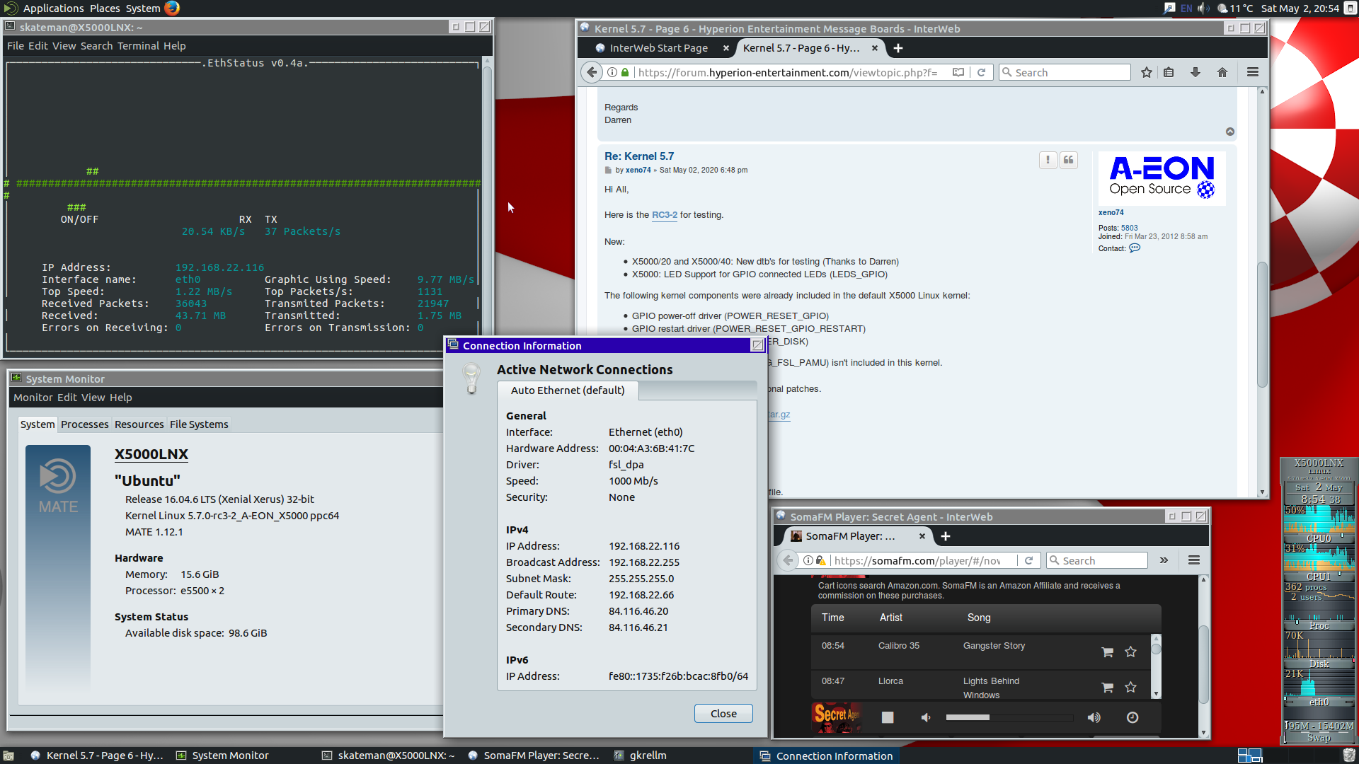

Kernel 5.7 RC3-2 up and running on the AmigaOne X5000. Using the new DTB by Darren.
Big picture: http://www.skateman.nl/wp-content/uploa ... 205438.png
Minor issue found... after the first boot with new dtb i had no Internet traffic, but at second reboot all was fine.
Great work guys!

Skateman wrote: Sat May 02, 2020 8:58 pm Kernel 5.7 RC3-2 up and running on the AmigaOne X5000. Using the new DTB by Darren.
Great work guys!
Strange, haven't seen that here. Keep an eye out and let me know if it happens again.

Screenshot of Fienix Soar 3.0-20200426 with the RC3-2 connected via the first DPAA Ethernet interface to the network:
Darren, many thanks for your work! We don't need the cyrus patch anymore! That's really great!

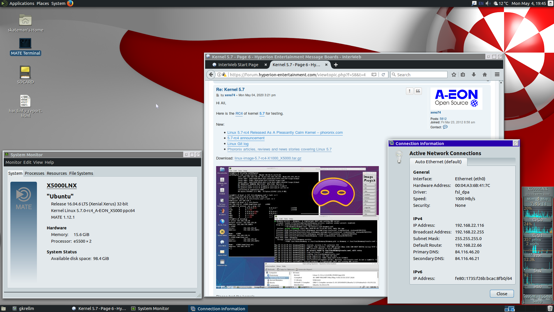

Kernel 5.7 RC4 up and running on the AmigaOne X5000
Big picture http://www.skateman.nl/wp-content/uploa ... 194514.png

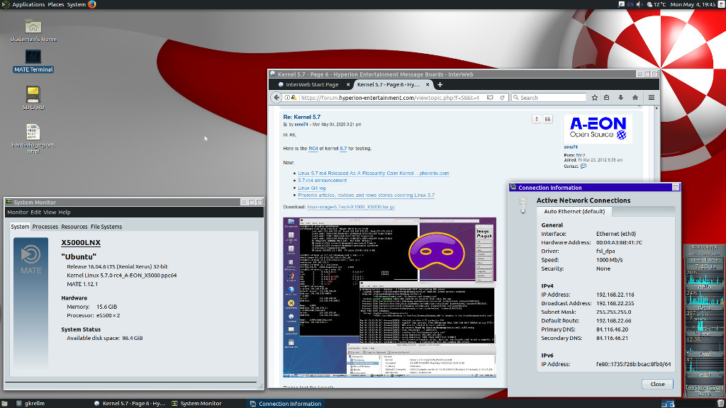

Re: Kernel 5.7
RC4 up and running fine. Thank you.
