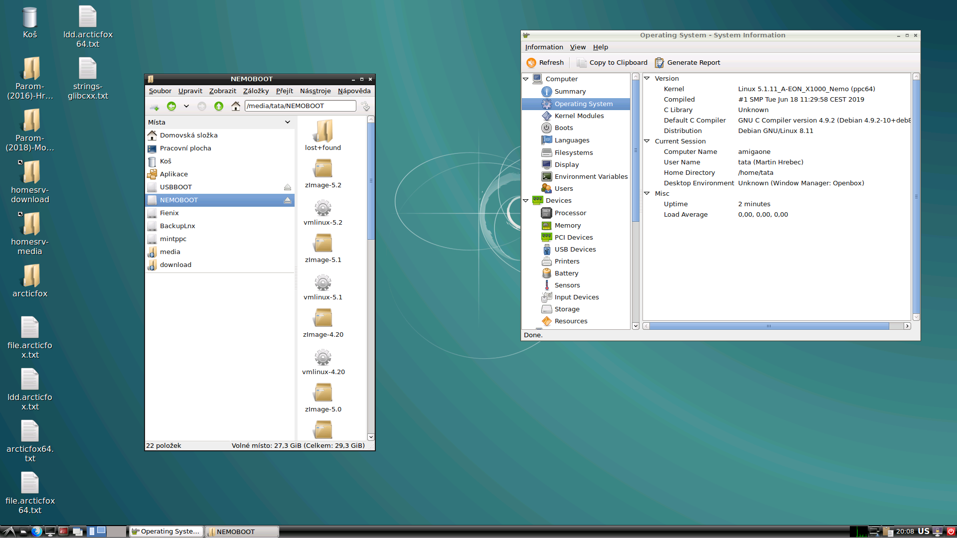

sailorMH
Posts: 334
Location: Czech republic
Re: Kernel 5.1
Post by sailorMH »
Thanks Christian,
cfcard works
Re: Kernel 5.1
sailorMH wrote:Thanks Christian,
cfcard works
Hi SailorMH,
Thanks a lot for testing the stable kernel 5.1.11 and many thanks for the screenshot! :-)
