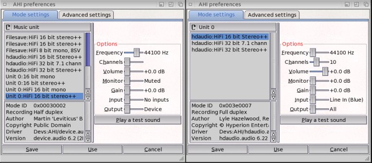

This happens when i delete ENV:Mixer.prefs
Now i doesn`t see the X1000 soundchip
Master Mute works i can set it on/off but has no effect to my sound output
Ok. Out of ideas now.
Just do the same (delete mixer.prefs, reboot sustem, unarchive BETA6 and try again) but with original BETA6 from previous post.

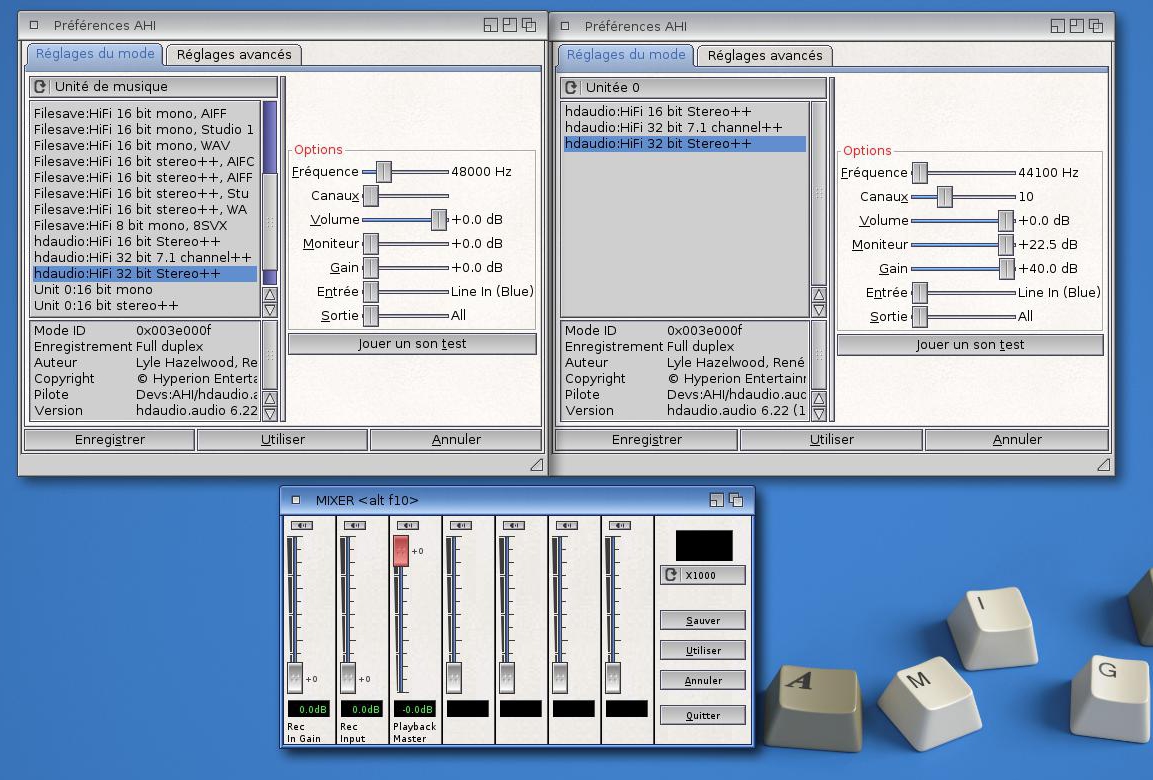

@tommysammy
Here are the AHI settings that work with Mixer on my X1000 system:
Re: Mixer.docky BETA supporting hdaudio V6.22
Post by zzd10h »
And mine, Mixer works well

tommysammy wrote: Maybe the soundchip on my beta X1000 is different to the FirstCustomer X1000 soundchips
the new mixer is working fine here on my x1000 - also the beta.
in all your screenshots the x1000 master volume is muted (red button) - are you 100% sure you unmuted it? and the volume goes down *very* fast (too fast imho) when moving the slider. be sure to have ot on topmost position.

zzd10h wrote:And mine, Mixer works well
i tried your settings and it doesn`t work here again. i give up because i have no idea to solve it.
