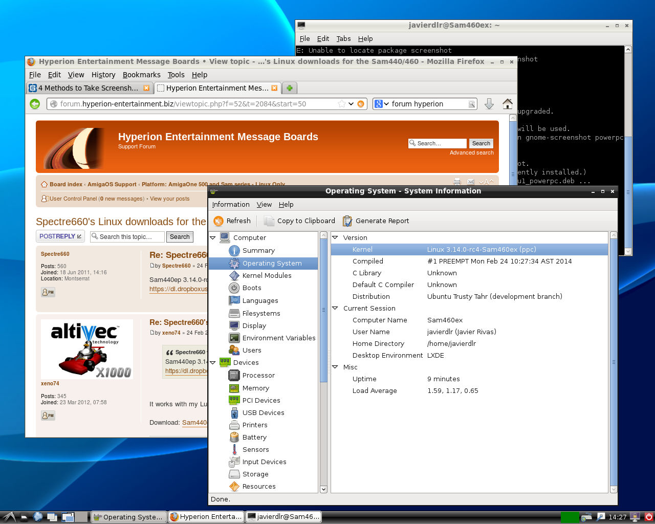

javierdlr
Posts: 393
Post by javierdlr »
Spectre660 wrote:Untested 3.14.0-rc4 Kernel for Sam460ex if any one wants to try it.
Warning I have not tested this as I still do not have a working Sam460ex .
https://dl.dropboxusercontent.com/u/542 ... rc4.tar.gz
WOW THX, will try it tomorrow!!!! :-D
EDIT1: works most of times!!! but sometimes it just shows a black screen (can almost see that text output is at top of screen, but just see 1-2 pixels wide) and the when trying to show lubuntu Welcome/Login screen it just shows a plain blue/white color. Will try to make some more test.
BTW when I update the kernel what files are "must have" in /boot ?
Speakijn about kernel 3.1x versions/revisions:
-/boot/uImage: of course is a "must have" it has/is kernel 3.x :-)
-/lib/modules/kernel3.x.x... : alas uImage, you must have each drawer for each kernel/uImage.
-/boot/canyonlands.dtb: does it matter if I use "old"/previous kernels canyonlands.dtb, or should I stick/use the one it comes with the kernel/uImage archive?
-/boot/System.map: the same question as canyonlands.dtb. Can I only use/have latest System.map for every kernel I load?
-/lib/firmware files: alas System.map, can I use latest firmware files doesn't matter what kernel I boot/load/use.
Now I'm using in menu.lst:
title Lubuntu 14.04 For Sam460ex
kernel /uImage313 root=/dev/sda11 radeon.dpm=0 console=ttyS0,115200 console=tty0
dtb /canyonlands313.dtb
title Lubuntu 14.04 (kernel 3.14rc)
kernel /uImage314 root=/dev/sda11 console=ttyS0,115200 console=tty0
dtb /canyonlands314.dtb
And using the same (latest) System.map and firmware files.
javierdlr@Sam460ex:/lib/modules$ ls /boot
canyonlands313.dtd  lost+found  System.map  uImage314
canyonlands314.dtb  menu.lst    uImage313
/lib/modules$ ls
3.13.0-rc7-Sam460ex  3.14.0-rc4-Sam460ex
lubuntu 14.04 with kernel 3.14.0rc on my SAM460ex
(205.92 KiB) Downloaded 94 times
javierdlr
Posts: 393
Post by javierdlr »
Ah, and I'm using SAM460ex kernel 3.14.0rc WITHOUT radeon.dpm=0 switch without problems.
KEEP THE GOOD WORK!!!!
