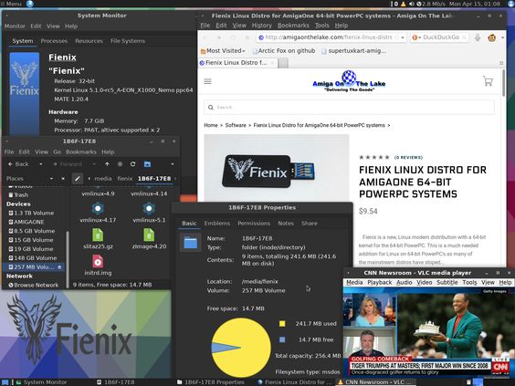

I released the RC3-3 of kernel 5.1 last week. This kernel was a RC3 with a lot of Git updates. That means, it didn't make any sense to release the RC4 because the RC3-3 has already included a lot of updates from the RC4.
Today, I released the RC5 of kernel 5.1 including all RC4 updates.
Issues:
  • X1000: There are some issues with new CF cards if you connected one of these to the onboard CompactFlash Card Slot. Note: The CompactFlash (CF) card slot is wired to the CPU local bus. It is typically used to hold the Linux kernels and initial ramdisks. If you want to use a new CF card then please use the stable kernel 4.20.16. Link to the test thread: Fienix - New PowerPC Distro
  • X5000: Initialization and use of secondary graphics card (FirePro 2260) does not work. Bug report: Bug 109345 - drm-next-2018-12-14 -Linux PPC. If you want to use a secondary graphics card for example a FirePro 2260 then please use the stable kernel 4.20.16.
  • X5000: Network issues with the DPAA ethernet. Further information: Kernel 5.0 thread
Download: linux-image-5.1-rc5-X1000_X5000.tar.gz
Screenshot of Fienix PowerPC with the RC5 of kernel 5.1 on a X1000:

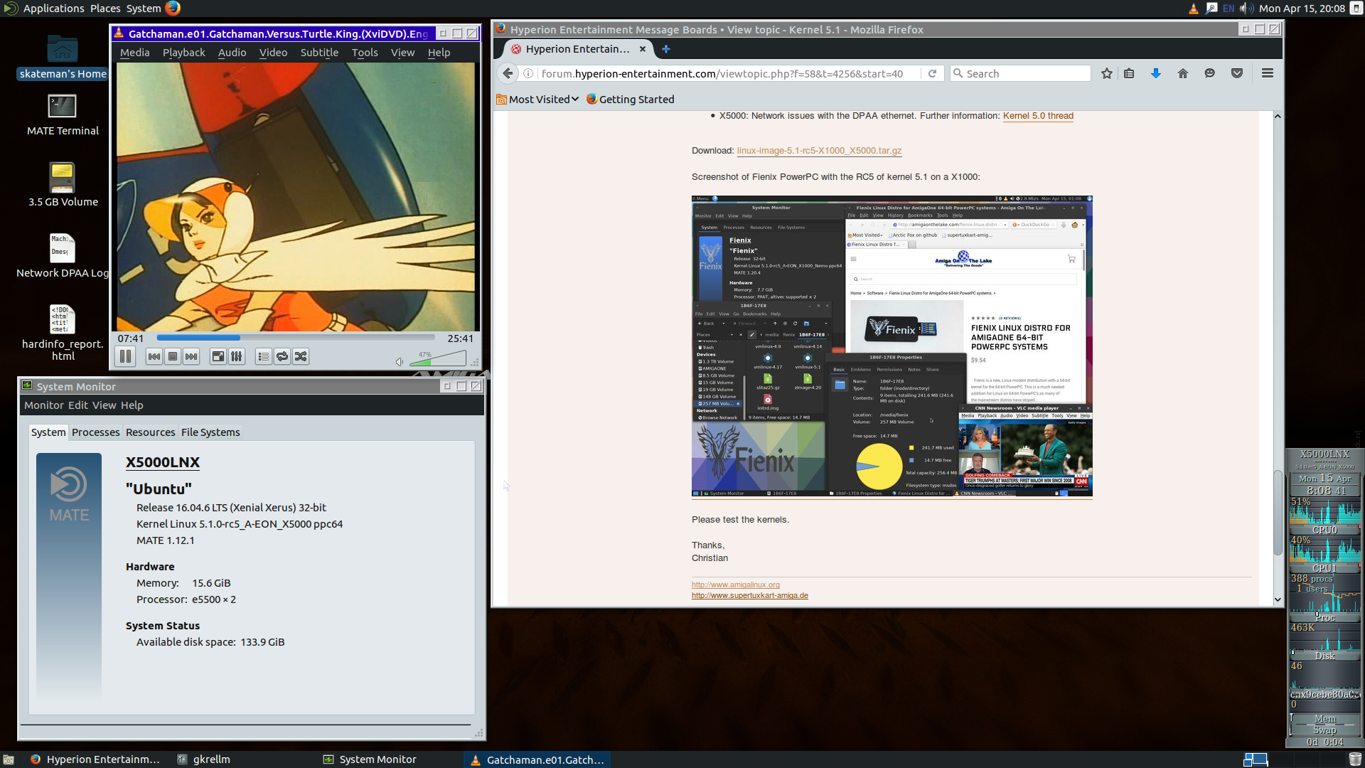

Posts: 977
Re: Kernel 5.1
Kernel 5.1 RC5 up and running on the AmigaOne X5000
Big picture http://www.skateman.nl/wp-content/uploa ... 200841.png
Posts: 11372
Re: Kernel 5.1
Thanks a lot for testing the RC5! :-)

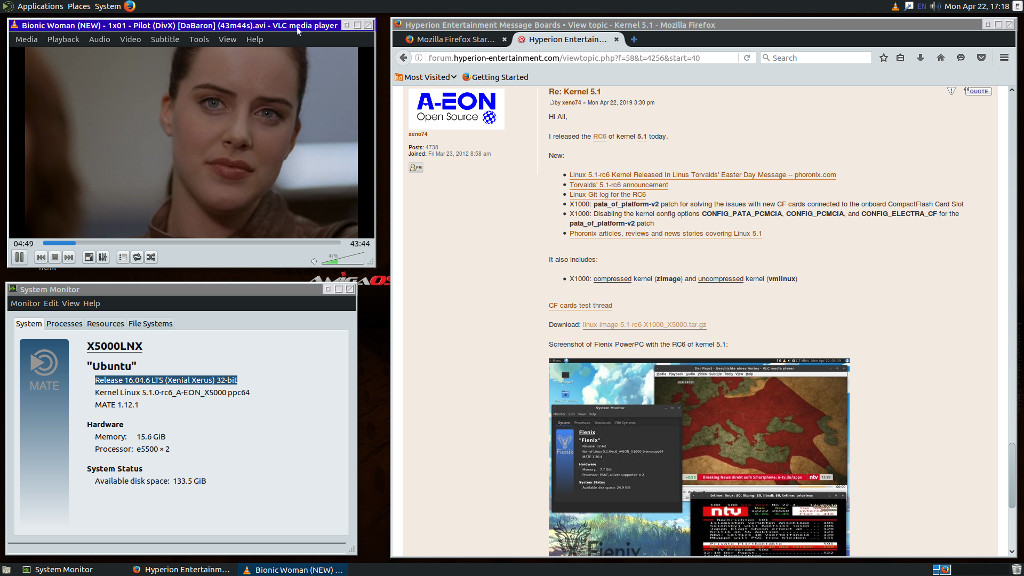

I released the RC6 of kernel 5.1 today.
CF cards test thread
Download: linux-image-5.1-rc6-X1000_X5000.tar.gz
Screenshot of Fienix PowerPC with the RC6 of kernel 5.1:
Posts: 977
Re: Kernel 5.1
Kernel 5.1 RC6 up and running on the AmigaOne X5000
Big picture http://www.skateman.nl/wp-content/uploa ... 171843.png
Posts: 11372
Re: Kernel 5.1
Skateman wrote:Kernel 5.1 RC6 up and running on the AmigaOne X5000
— Christian
