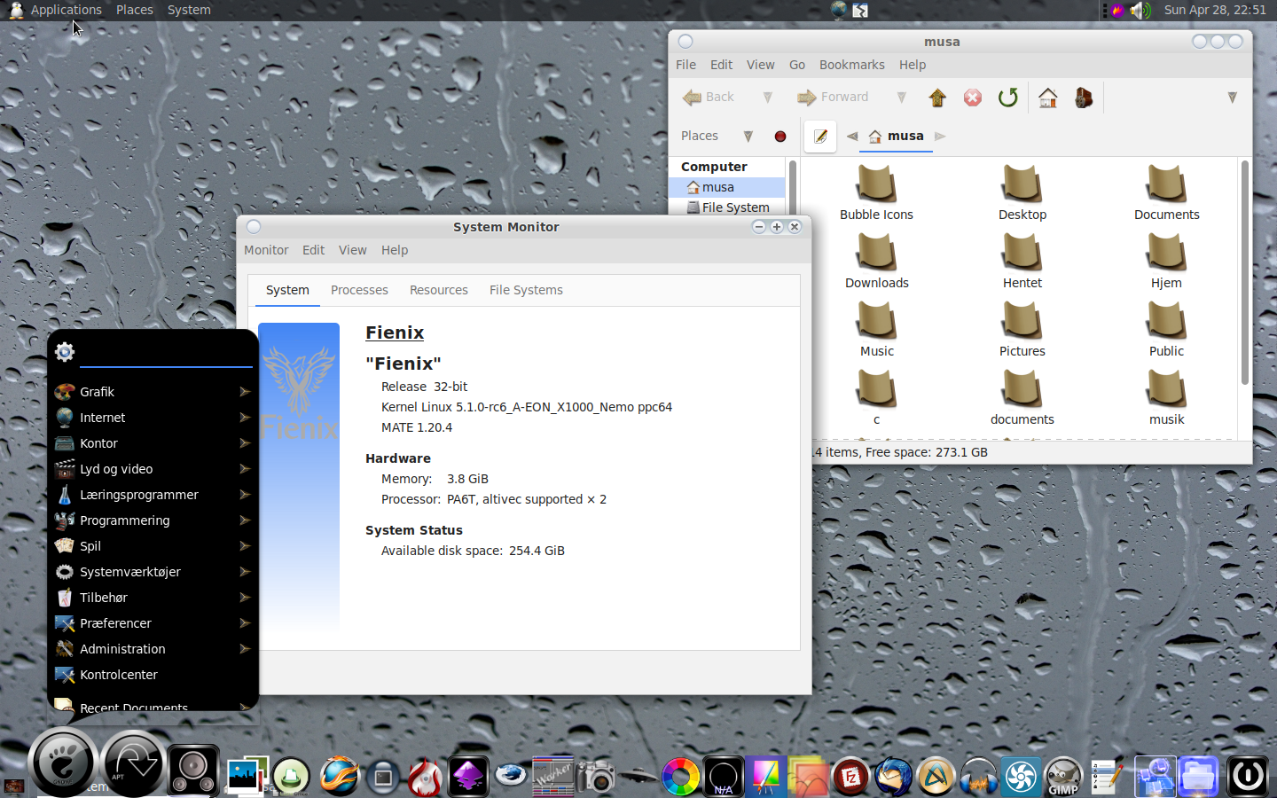

Hi
Testing kernel 5.1.0-rc6
No problem
Posts: 11064
Re: Kernel 5.1
musa wrote:Hi
No problem
Thanks a lot for testing the RC6! :-)

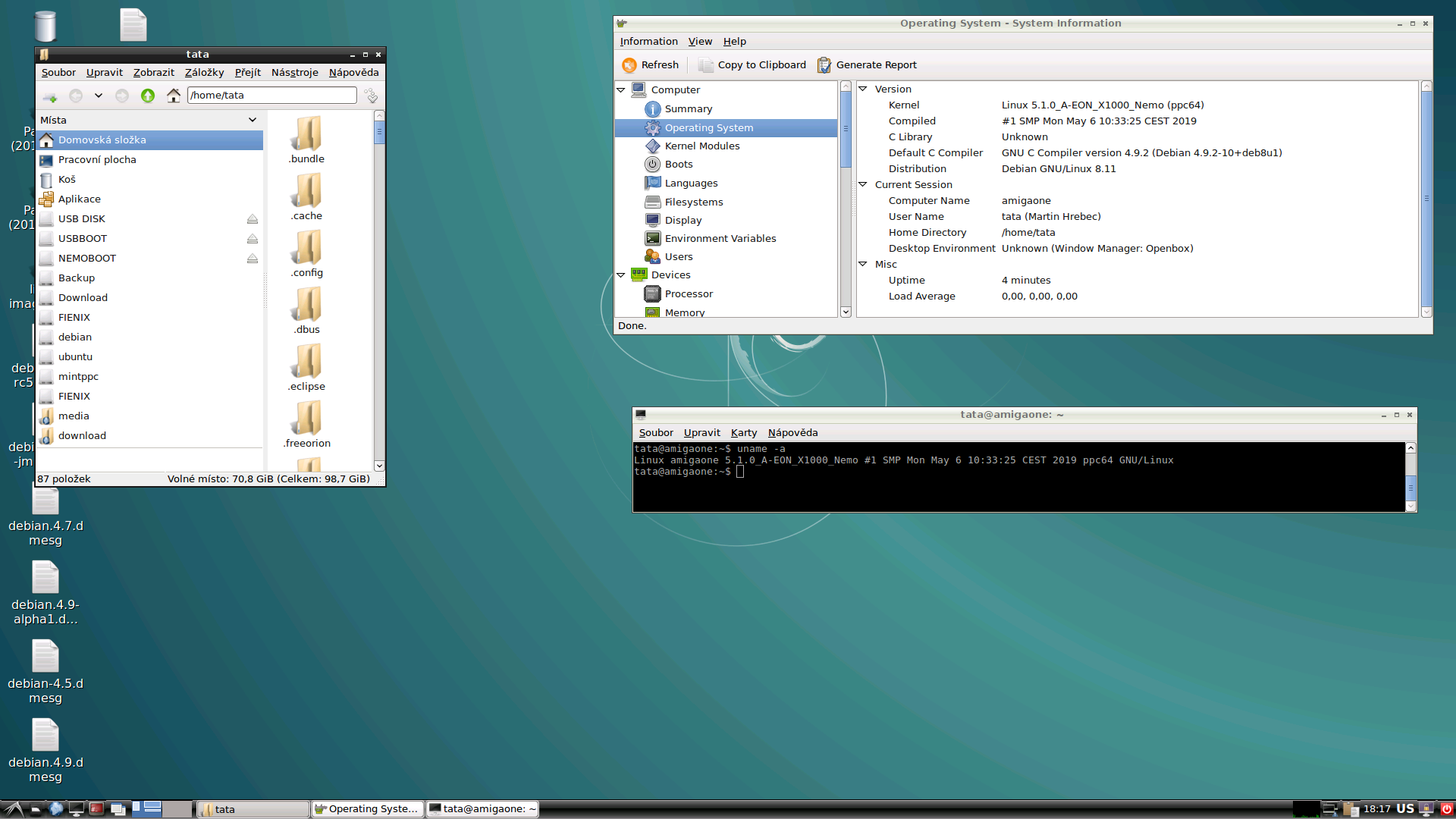

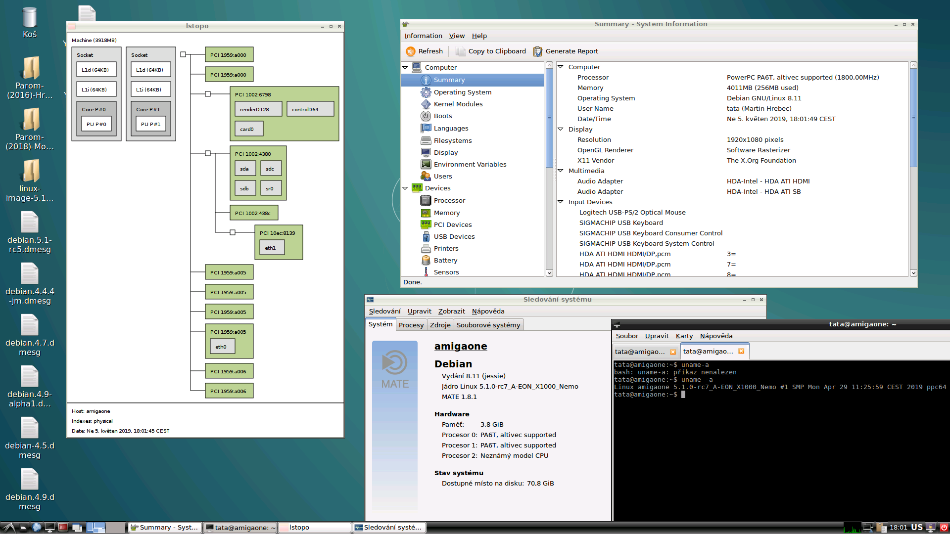

tested and works with Debian8 and Fienix.
Note:
lstopo (hwloc-ls) shows PA-Semi like two socket system, not onesocket dualcore.
Do somebody know, from where gather hwloc the informations?

sailorMH wrote:Thanks,
Note:
Hi SailorMH,
Many thanks for testing the RC7 and thanks a lot for the interesting screenshot. :-)

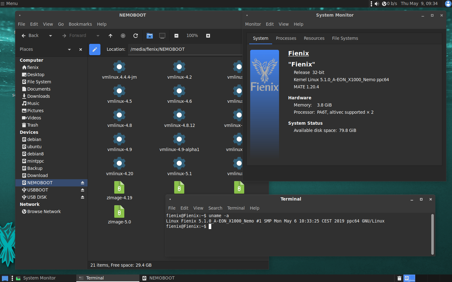

Screenshot of Lubuntu 16.04.6 LTS PowerPC with the New Moon 28.4.1 and with the final kernel 5.1:
Have a nice week! :-)
