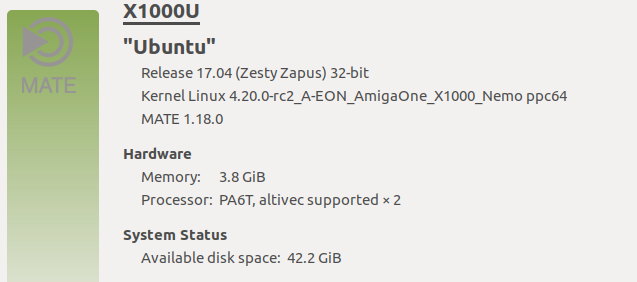

Linus Torvalds released the RC2 of kernel 4.20 for testing today.
Download: vmlinux-4.20-rc2-AmigaOne_X1000_X5000.tar.gz
Screenshot of ubuntu MATE 16.04.5 LTS PowerPC with the kernel 4.20-rc2 and with connected Bluetooth devices:

4.20-rc2 is up and going well here (4.19.1 as well).
The compressed kernel comes off CF0: noticeably faster.
Loading ramdisk first and using
setenv bootargs "root=LABEL=AMIGAONE rw"
works.
