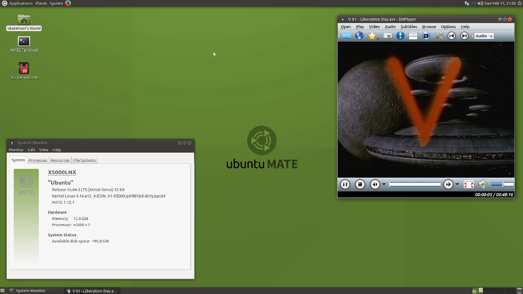

Alpha 12 .. no issues for now :-)

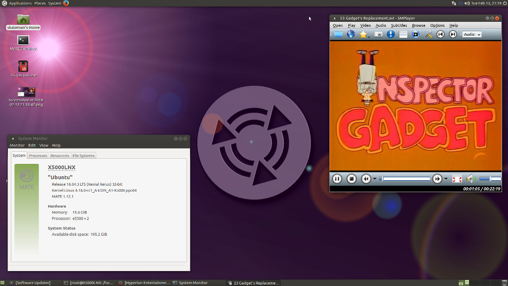

I compiled the RC1-2 for the X5000 and X1000 yesterday.
Download: vmlinux-4.16-rc1-2-AmigaOne_X1000_X5000.tar.gz
@Skateman
Many thanks for testing the RC1 on your X5000.
Posts: 977
Re: Kernel 4.16
RC 1-2 up and running :-) ... no issues yet..
Posts: 11373
Re: Kernel 4.16
Skateman wrote:RC 1-2 up and running :-) ... no issues yet..
