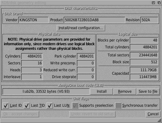

X1000 doesn't use SLB loader it uses amigaboot.ub (in a SD or alike)
SAM460 machine do need SLB to find/boot AmigaOS4. You just need to open MediaToolbox and in 'AmigaONe boot code (SLB)' you should see/have in L:slb_v2
Just open/start MTB, choose your HDD and choose 'Edit RDB/Reinstall...' option and post here waht you have/see in 'AmigaONe boot code (SLB)' (read only) stringgadget.
My L:slb_v2 is:
Version 1.19 (26-11-2008)
[Compile options: CD booting, HD booting, SFS support, Linux on RDB booting, TFTP boot support.]
NOTE: I use 'l:ub2lb' (as listed in MTB grab) 'cos have linux partitions and so, but you should install/use L:slb_v2

javierdlr wrote: SAM460 machine do need SLB to find/boot AmigaOS4. You just need to open MediaToolbox and in 'AmigaONe boot code (SLB)' you should see/have in L:slb_v2
You must have forgotten that it is very difficult to open Media Toolbox if you can't boot Workbench. ???
