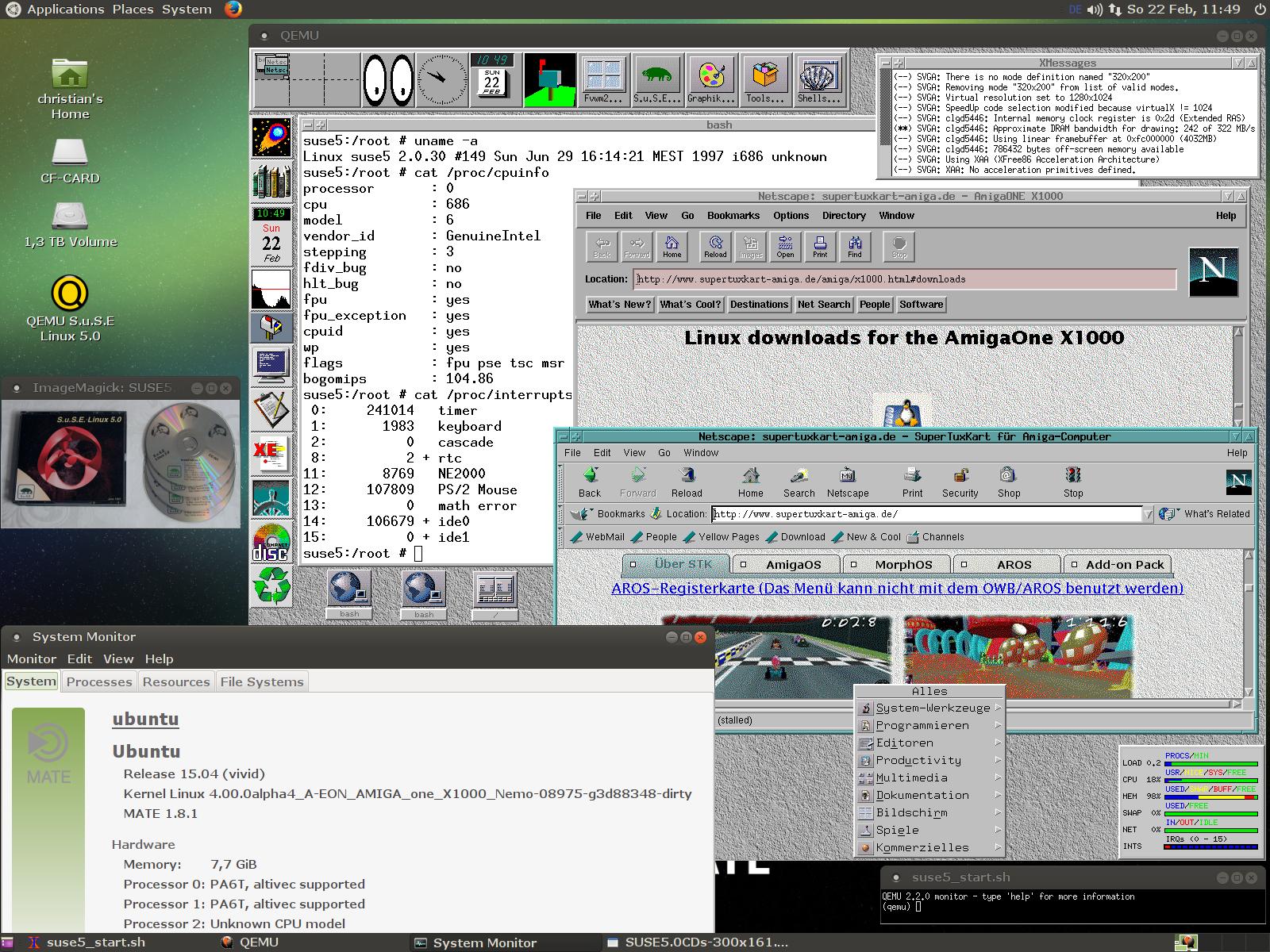

musa wrote: By the way, which Linux do you use with qemu
I use my old x86 S.u.S.E Linux 5.0 from 1997:
And I use ubuntu MATE 15.04 PowerPC with QEMU/KVM:
