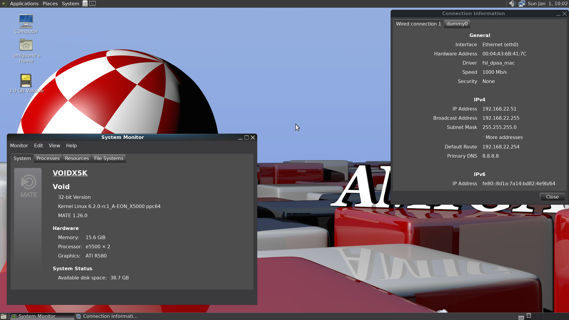

Skateman wrote: Thu Dec 29, 2022 12:31 pm Thats correct, but the DTB will not be loaded correctly and the onboard NIC will not be adressed correctly and is disabled.
There still is something wong....
Unfortunately I'm still using a PCI ethernet card and not the onboard NIC, so I didn't notice this issue.

Posts: 973
Yess!
With the old dpaa kernel you compiled the issue has resolved.
I did use the 1000000 - 2000000 addresses to boot due to the CRC error when using 1000000 - 1c00000
Big picture: https://www.skateman.nl/wp-content/uplo ... -02-15.png
Dave
Posts: 11246
Skateman wrote: Sun Jan 01, 2023 11:08 am Yess!
Hi Dave,
Happy New Year! Thanks a lot for testing the RC1 of kernel 6.2 with the old dpaa driver! :-)
It seems, that the new driver doesn’t work with our onboard network interfaces. :-(
I will report this issue to the kernel developers.
