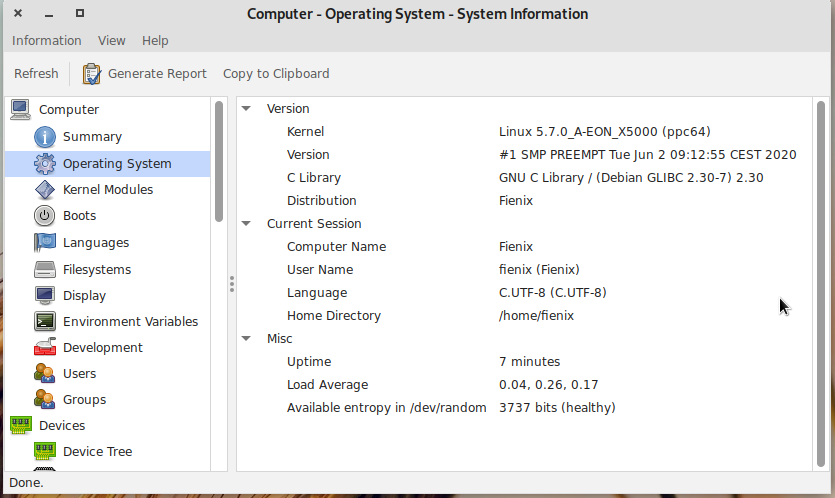

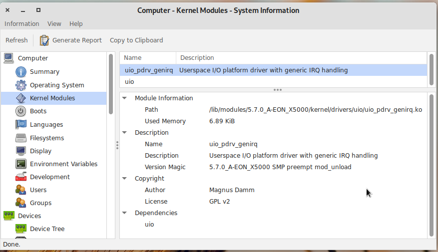

Amiguy
Posts: 93
Re: No Ethernet with... Sound Blaster card ?
Post by Amiguy »
I installed the 5.7 kernel which makes the CMI sound card and Ethernet work fine, but not the Sound Blaster.
Here are the results of my test orders:

lsmod:
Module                  Size  Used by
uio_pdrv_genirq         7051  0
uio                    19682  1 uio_pdrv_genirq
