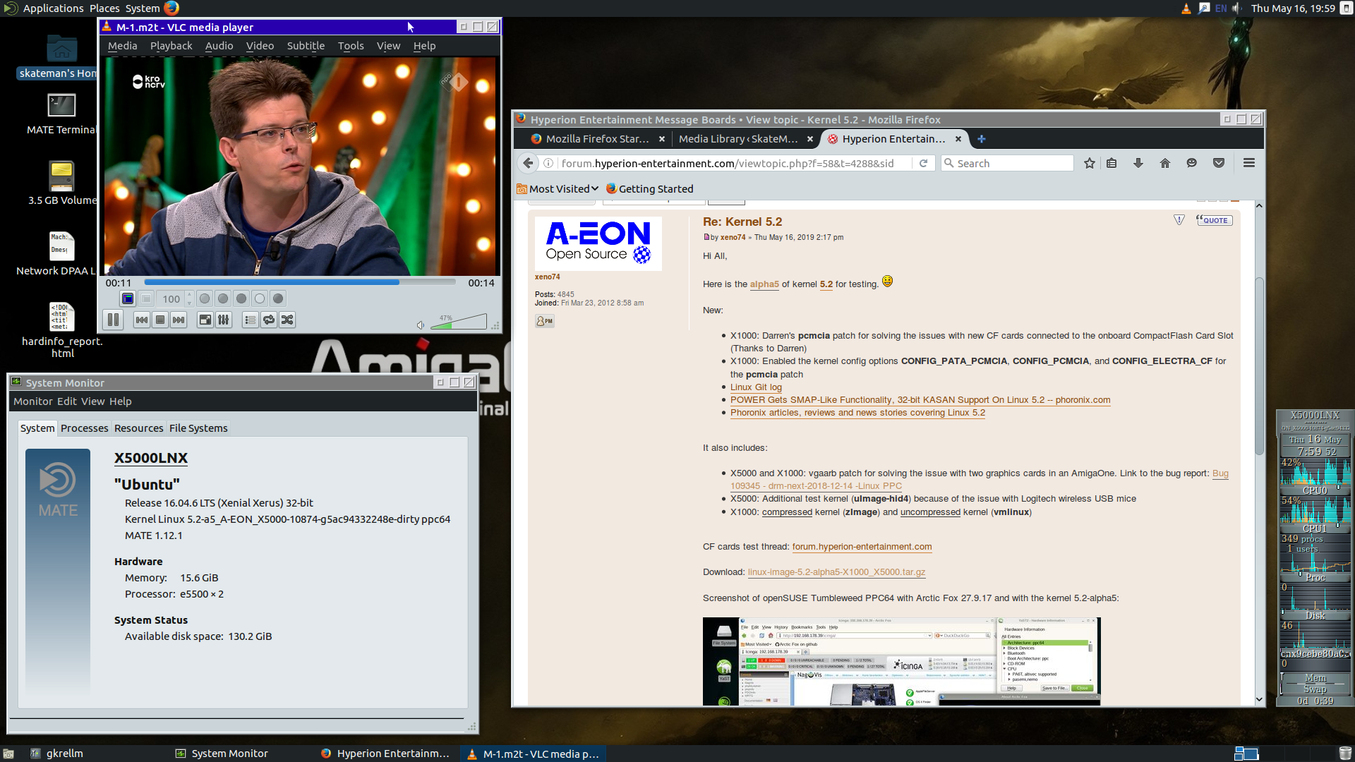

Posts: 977
Re: Kernel 5.2
Kernel 5.2 Alpha 5 is alive... on my AmigaOne X5000!
Big picture: http://www.skateman.nl/wp-content/uploa ... 195952.png
Posts: 11372
Re: Kernel 5.2
Skateman wrote:Kernel 5.2 Alpha 5 is alive... on my AmigaOne X5000!
Thank you for testing the alpha5! :-)
Have a nice weekend! :-)

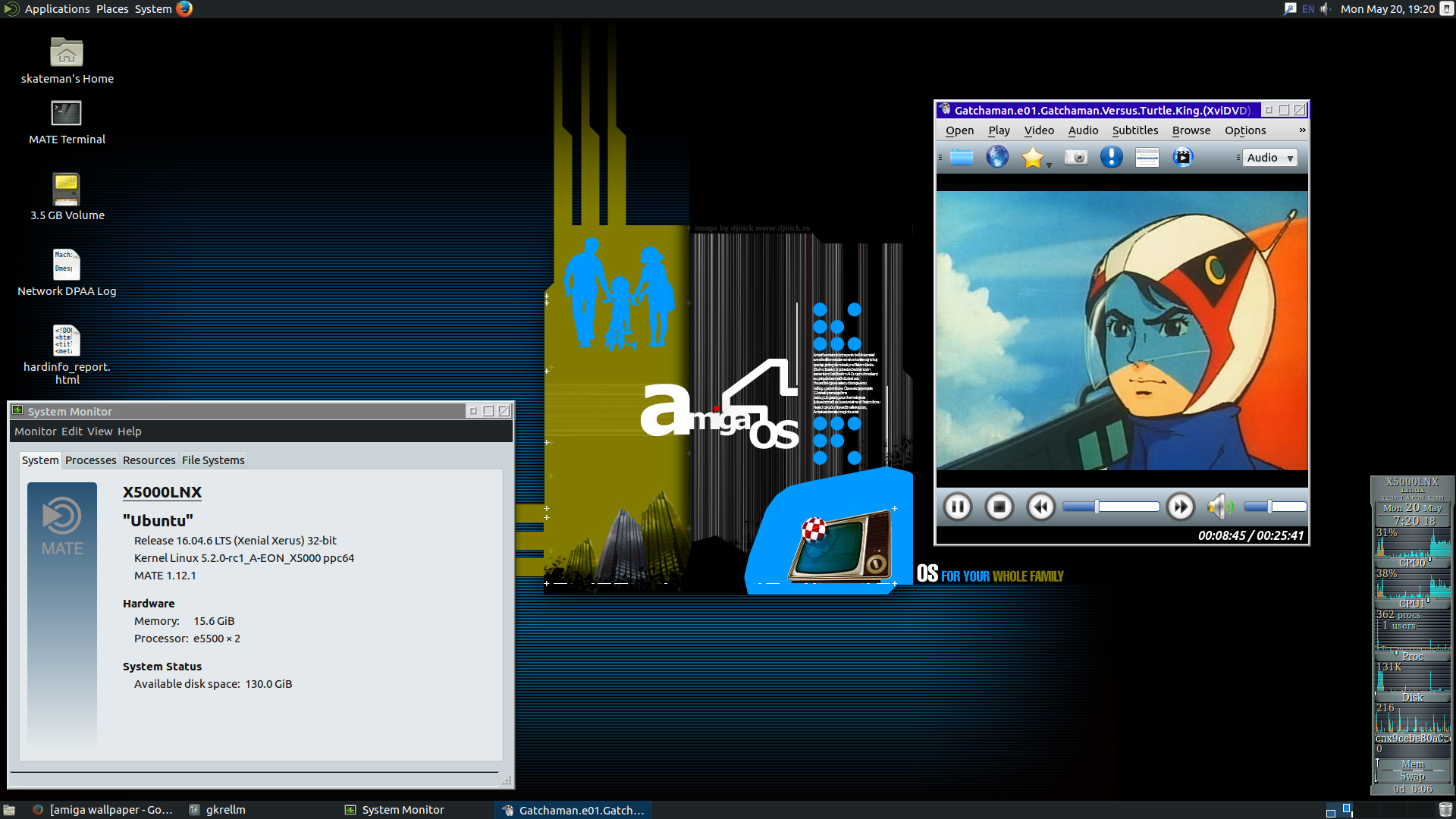

Posts: 977
Re: Kernel 5.2
Kernel 5.2 RC1 up and running on the AmigaOne X5000
Big picture http://www.skateman.nl/wp-content/uploa ... 192018.png
Posts: 11372
Re: Kernel 5.2
Skateman wrote:Kernel 5.2 RC1 up and running on the AmigaOne X5000
Thanks a lot for testing the RC1! :-)
