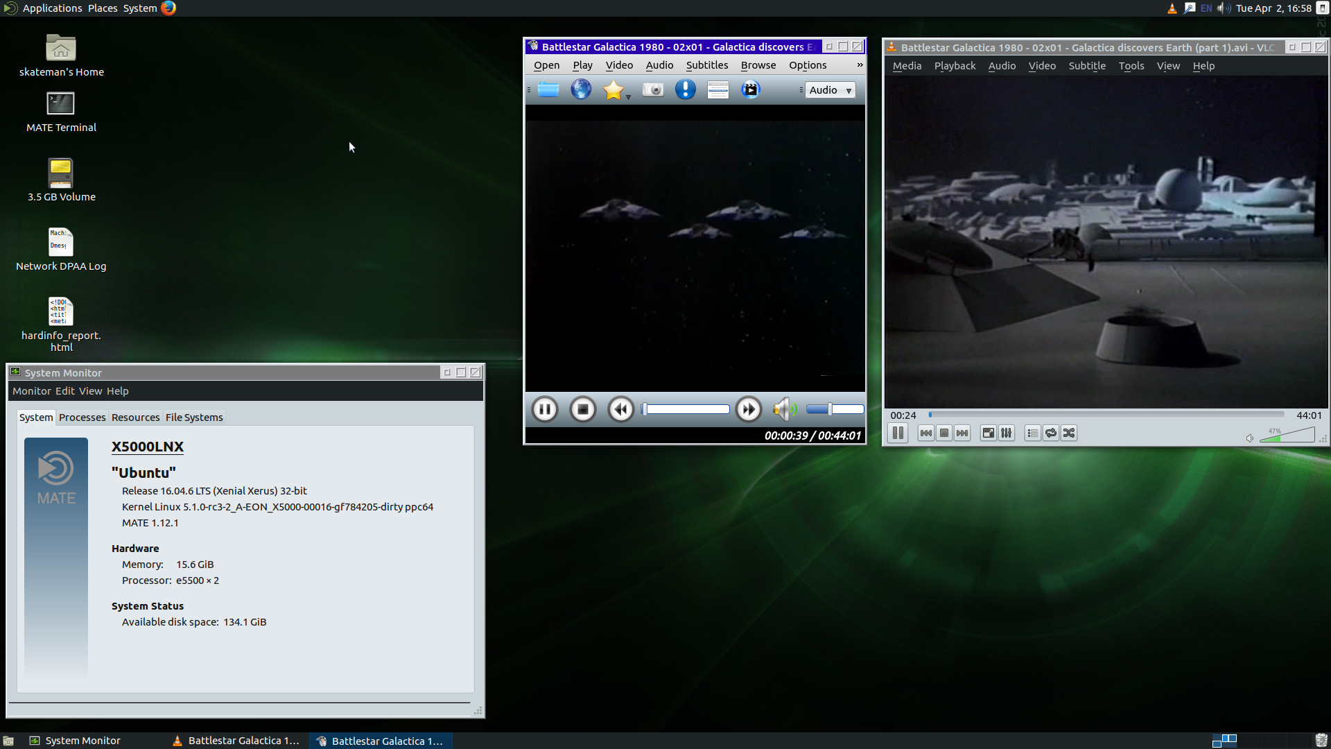

RC3-2 fixed the video problem. Both SMtube and VLC play correctly on my AmigaOne X5000!
Big Picture http://www.skateman.nl/wp-content/uploa ... 165855.png

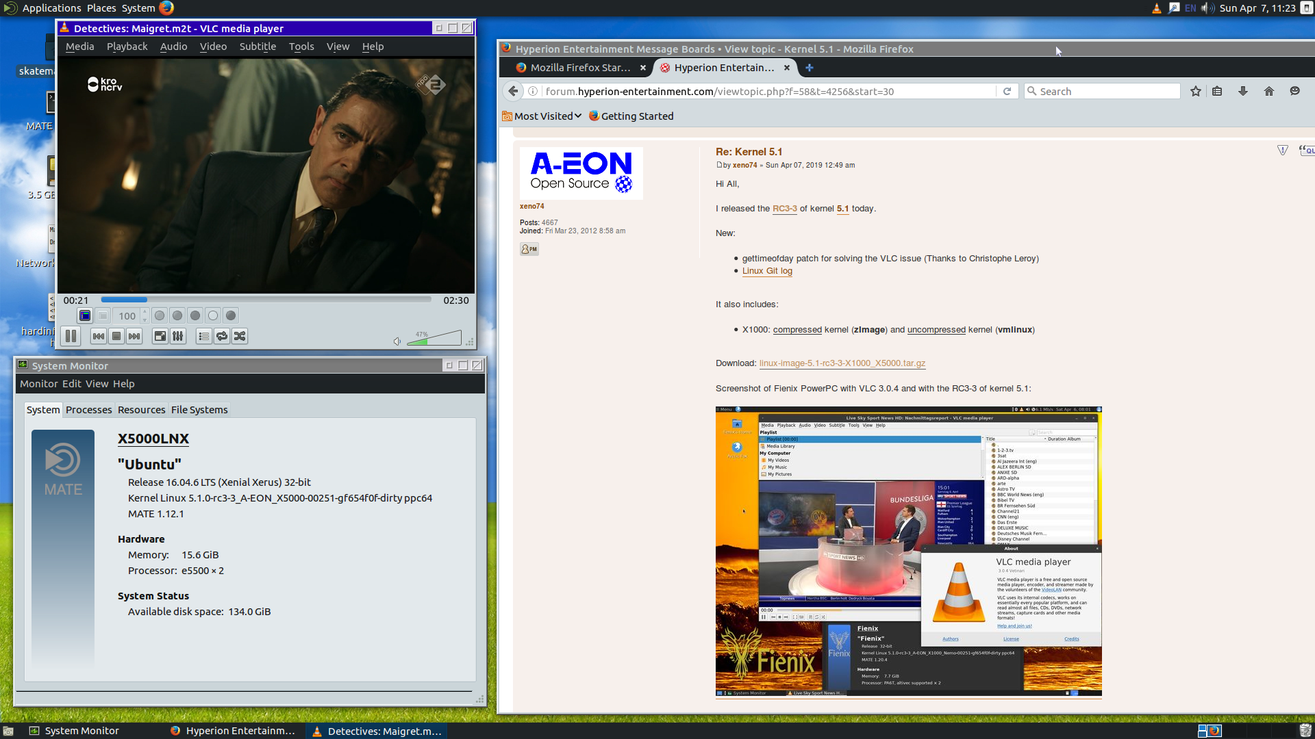

Screenshot of Fienix PowerPC with VLC 3.0.4 and with the RC3-3 of kernel 5.1:
Posts: 977
Re: Kernel 5.1
RC3-3 running fine on the AmigaOne X5000 :-)
big picture http://www.skateman.nl/wp-content/uploa ... 112321.png
