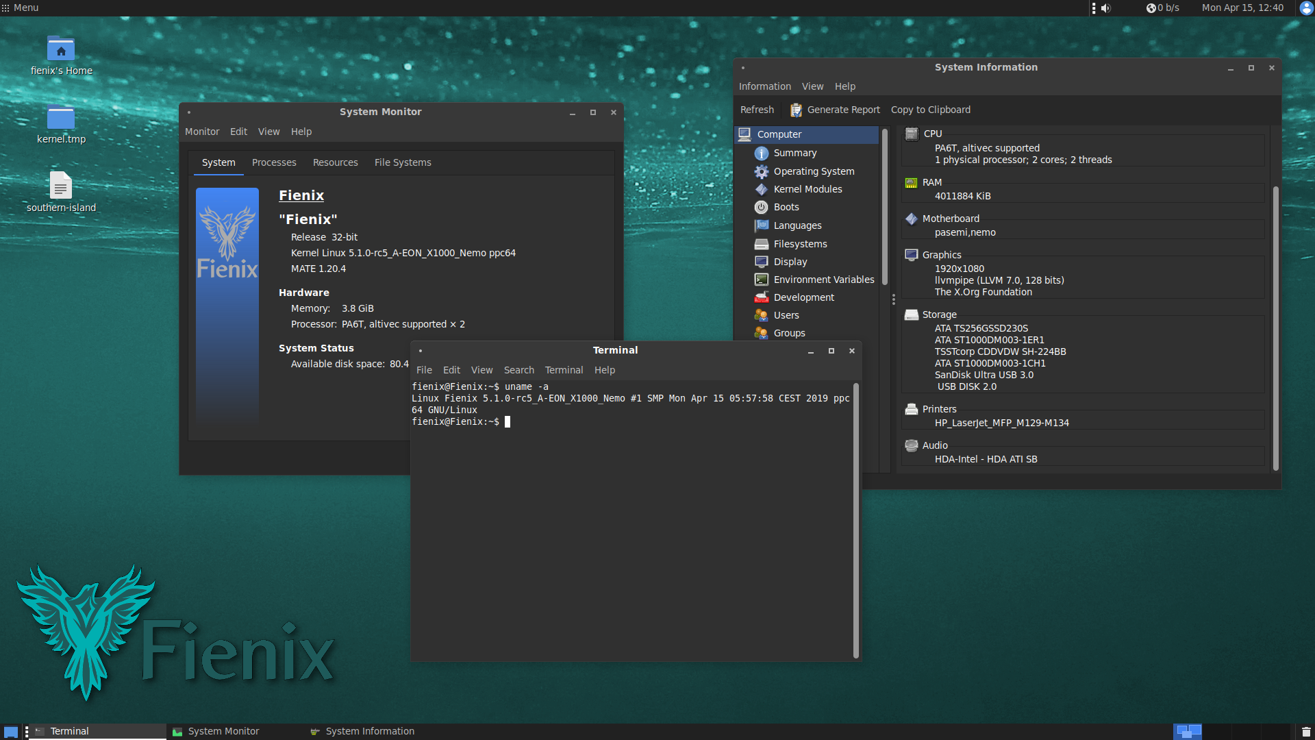

Screenshot of Fienix PowerPC with the RC5 of kernel 5.1 on a X1000:
sailorMH
Posts: 334
Location: Czech republic
Re: Kernel 5.1
Post by sailorMH »
5.1-rc5 works fine.
