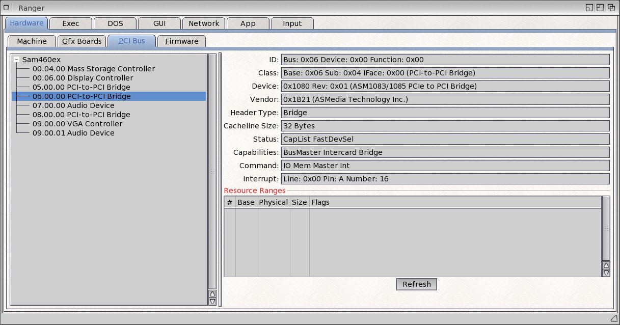

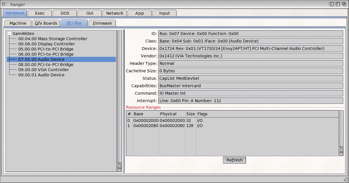

The ASM1083 may not be the issue at all.
I have an Envy24HT pciex1 card with an ASM1083 revision 1 that works with simultaneous audio and video playback on the Sam460ex.
Sound card purchased from ACube .
The AMS1083 revison 1 chips on both my CMI8738 and my first Envy24HT have the markings
BAW43201B1 1124
Markings on my second Envy24HT with the revison 3 ASM1083 are
BMH04501B2 1351

Re: Odyssey - YouTube - Offline Movies - system freezes
I'm not sure if the Sam460 is a good testbed. At least the CMI driver includes workarounds for the ASMedia problem if ran on Sam460, which work there, because a different IRQ is used and the original one not shared. We can't use the same technique on other machines unfortunately. Even without that specific workaround, on a Sam460, the sound card/ASMedia does not need to share its interrupt, which greatly influences experience. (for example, I also have a workaround for the CMI cards on X5000, which works as long as the interrupt is not shared.. obviously that is nothing to bet on)Spectre660 wrote: The ASM1083 may not be the issue at all.
So the real question is: does the card work in the X5000?

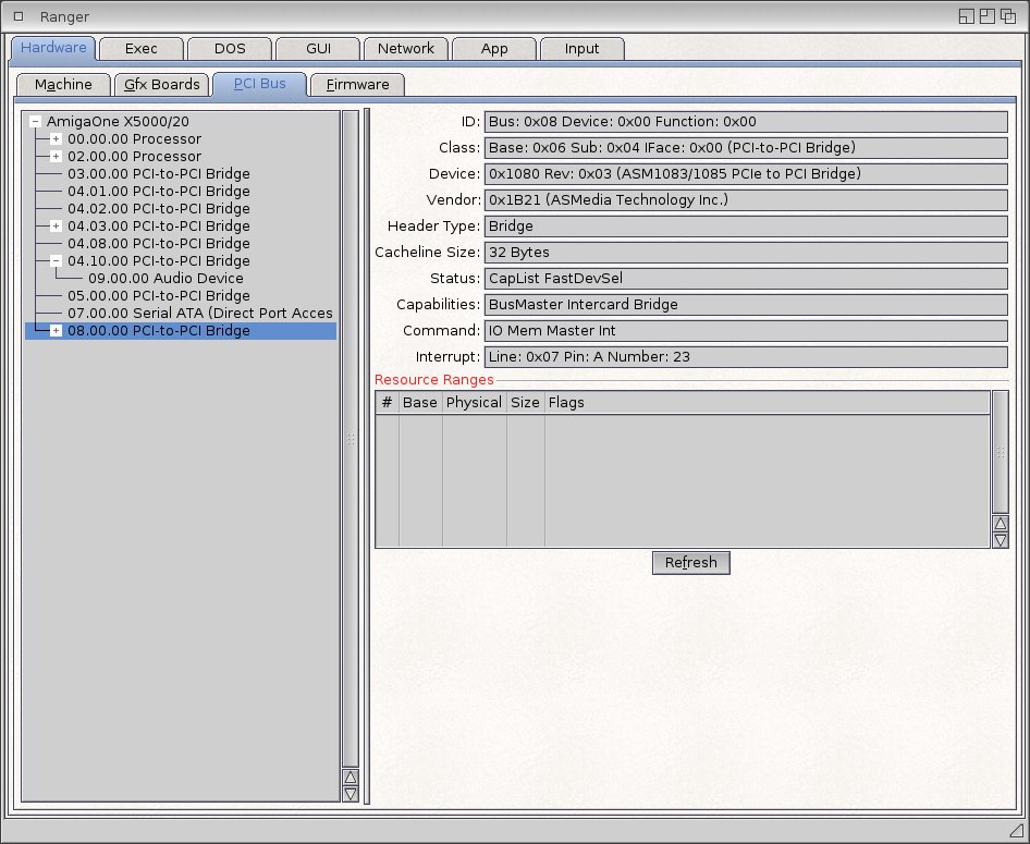

I have asked seventhwonder to post detail of the Envy24HT being used in his X5000 .
Cyborg wrote:I'm not sure if the Sam460 is a good testbed. At least the CMI driver includes workarounds for the ASMedia problem if ran on Sam460, which work there, because a different IRQ is used and the original one not shared. We can't use the same technique on other machines unfortunately. Even without that specific workaround, on a Sam460, the sound card/ASMedia does not need to share its interrupt, which greatly influences experience. (for example, I also have a workaround for the CMI cards on X5000, which works as long as the interrupt is not shared.. obviously that is nothing to bet on)Spectre660 wrote: The ASM1083 may not be the issue at all.

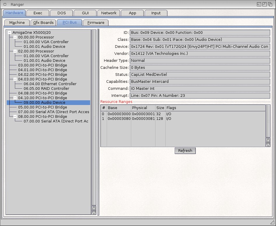

Here is the information from my X5000
@ seventhwonder
Thanks .
Can you post the bridge chip info like the first image in my post.
http://forum.hyperion-entertainment.biz ... &mode=view
Thanks .
Please find it below:Spectre660 wrote:@ seventhwonder
Thanks .
@ seventhwonder
Thank you.
Your card has a revision 3 ASM 1083 chip .
One of mine has a revision 3 chip as well but the other one has a revision 1 chip .
Thank you.
