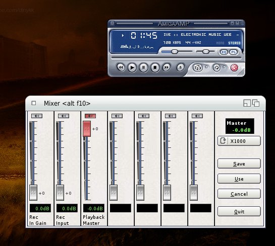

Why are the 2 leftmost sliders at minimum ?
tommysammy
Posts: 946
Location: Isselburg,Germany
Re: Mixer.docky BETA supporting hdaudio V6.22
Post by tommysammy »
zzd10h wrote:Why are the 2 leftmost sliders at minimum ?
I don`t know it . This are the original settings at the first start.
I played with all sliders but nothing happen here
Post by zzd10h »
You are right, I just tried, it has no effect (it still works for me).
Of course, you tried without the Master mute indicator ON (red button)
On Beta OS or on standard one ?
