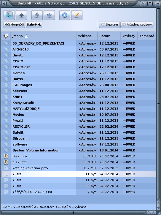

I tried it with several filenames:
Y-ň.txt
Y-ř.txt
Y-ťďň-ŤĎŇ.txt
Mos omits only these letters: ř,ť,ď,ň. Others are visible ( i.e. probably have equivalent in ISO-8859-1 or ISO-8859-15)
MOS ambient winow file listing
(100.58 KiB) Downloaded 211 times
Anyway, it is only under ambient. In shell I see normally all characters.

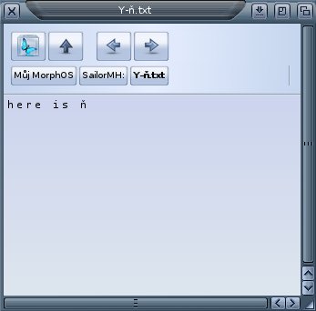

In ambient window I can still edit "identical" files separately (see filename Y-ň.txt on top):

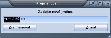

And if I use rename function from Ambient window, I also see all characters:
i.e. MOS handles names separately - in shell is everything OK,
only some upper programs (ambient window, Dopus) does not show all characters.
