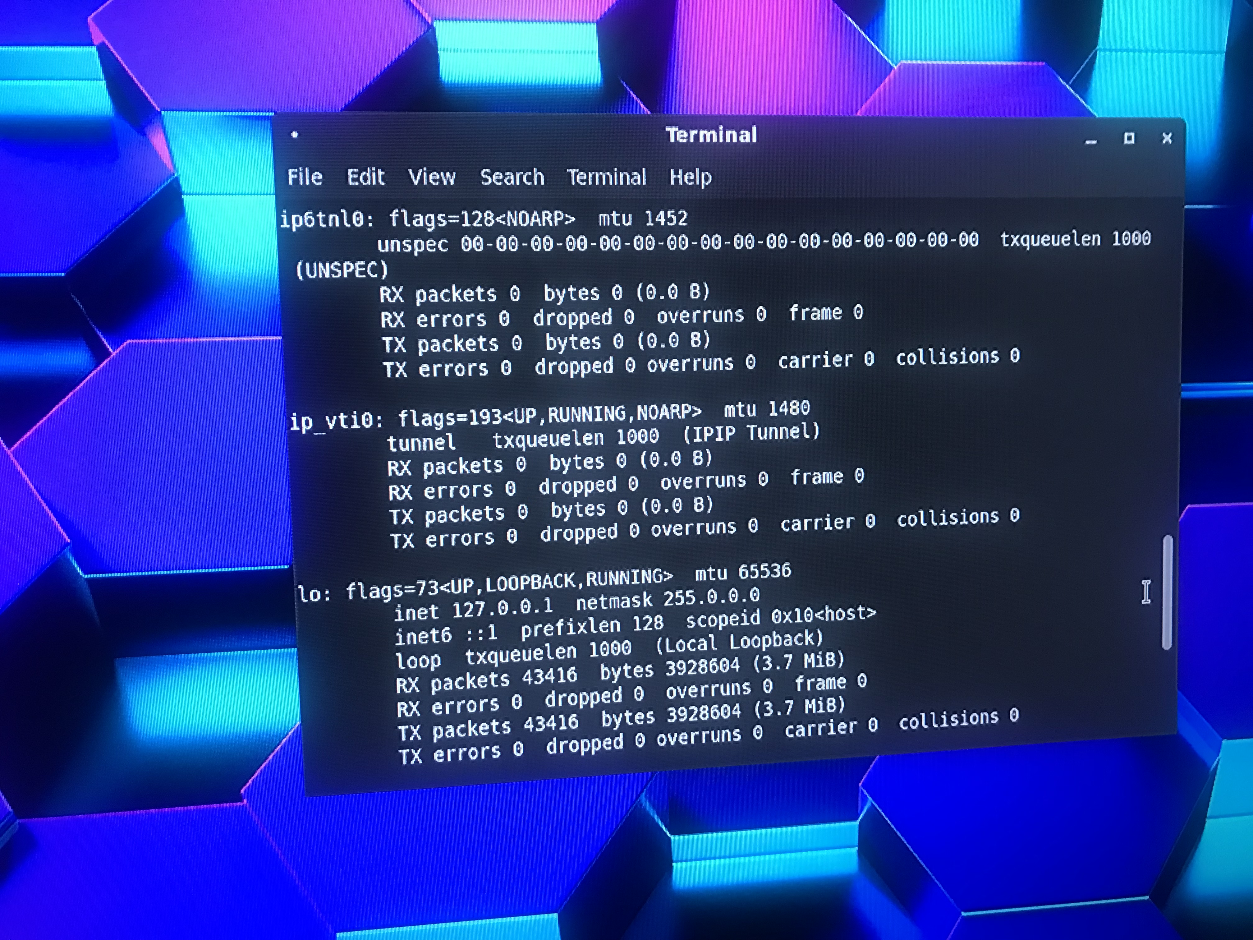

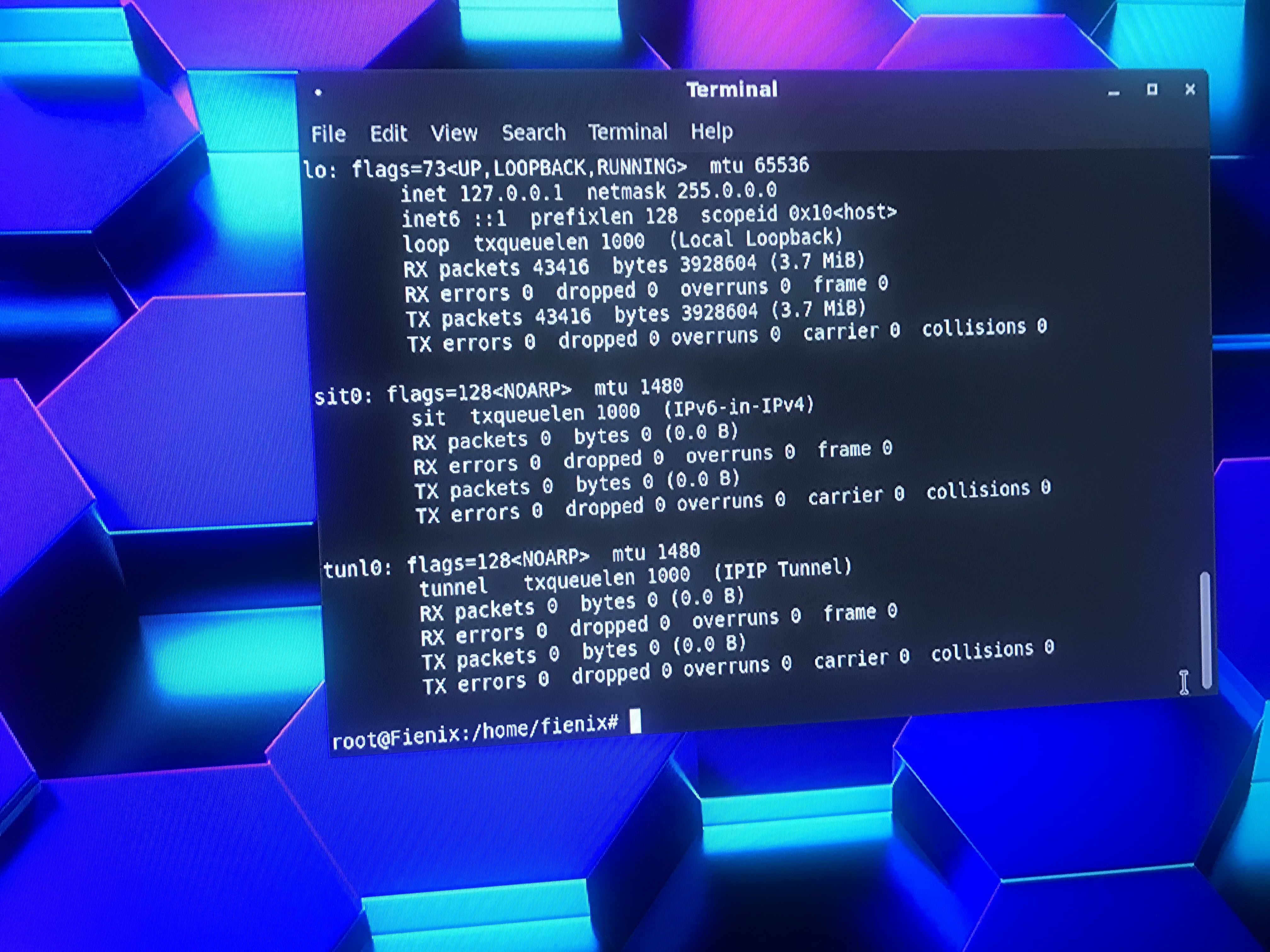

Fienix usb from aotl working . Still no Ethernet though after the dummy one being blocked .using Realtek 8139 from aotl.
Trying/shin/ifcongig -a gives me these readouts.the 8139 works fine on Amiga side.
Posts: 968
in the third screenshot there is an enP4096.... adapter which is the working one. I has the 192.168.1.x ip adress.
Check if you can ping your router. (gateway)
