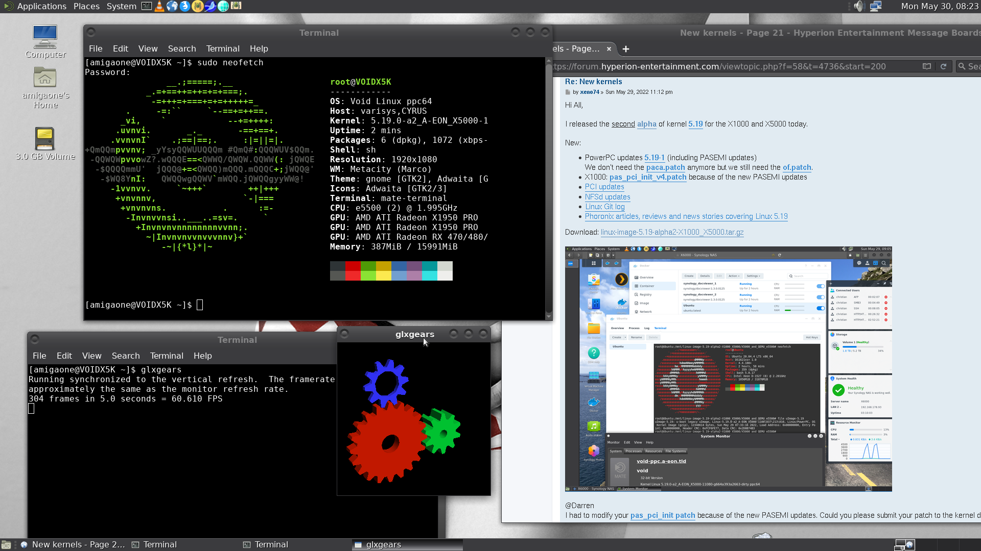

Kernel 5.19 Alpha2 up and running on my AmigaOne X5000
https://www.skateman.nl/wp-content/uplo ... -23-12.png
