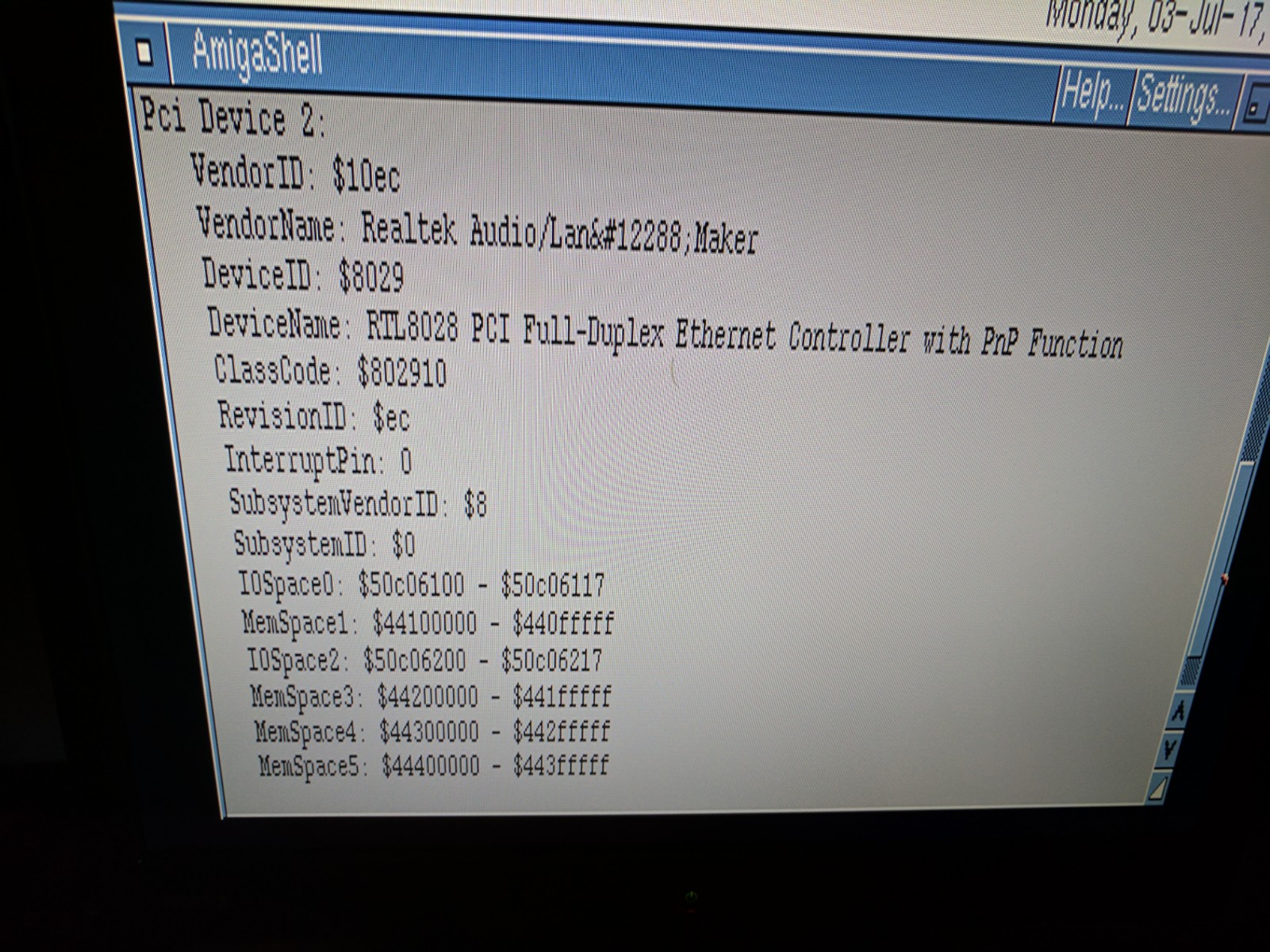

Sorry to revive this thread but I'm having issues getting an RTL8029 card to work in AOS 4.1 FE (not yet updated, cause I need network connectivity, duh)
My system:
Recapped Amiga 4000D with ATX PSU, 16 MB fast, 2 MB chip, Kick 3.1
CSPPC + 128MB
Mediator 4000Di MKiii 3,3 v
Bigramplus 256 MB
Highway USB
Voodoo3 3000
RTL8029 NIC, in the lowest slot right above the mediator bridgeboard (and tried it in different slots with same result)
Everything works (well, haven't tried the bigram yet as I need update1 for that) except for the network card.
The network card works without a problem in AOS3.9.
Then I read this thread, no idea if it is still valid for the later AOS4.x versions as it is already a bit old.
But trying the ENVARC thing doesn't work or either I don't do it correctly.
I tried both:
- a file unit0 in /envarc/rtl8029.device/ containing the string (without brackets) "VENDORID 0x0008 DEVICEID 0x8029"
- a file unit0 in /envarc/rtl8029.device/ containing the string (without brackets) "VENDORID=0x0008 DEVICEID=0x8029"
- two files: 1) a file VENDORID in /envarc/rtl8029.device/unit0/ containing the string (without brackets) "0x0008" 2) - a file DEVICEID in /envarc/rtl8029.device/unit0/ containing the string (without brackets) "0x8029"
All to no avail, the network card device cannot be opened. Weird thing is that PCiinfo in AOS3.9 shows a different vendorid than Ranger in AOS4.1, see attached images.

OK, so I give up with the rtl8029 PCI card. I can't get it to work.
I tried several ENV: settings.
I tried multiple jumper configs on the mediator board.
Nothing works. Maybe I still need to use different VENDORID/DEVICEID settings? The card shows the following:
HT-2100PCI on a sticker and HT-8029as on the PCB.
I tried with my AriadneII card and that thing worked flawlessly in AOS4.1. But I can't use that one, I need the space for other stuff. Would a combination of X-Surf 1000 & RapidRoad work?
