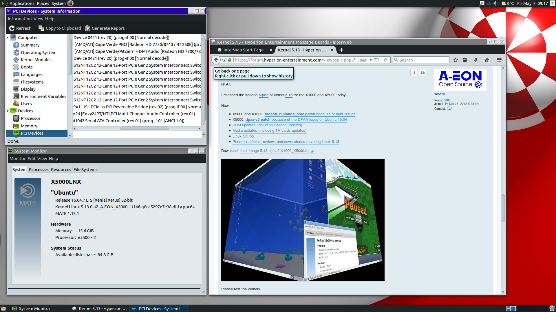

Kernel 5.13 Alpha2 is running fine on my X5000 with R7 250 videocard.
Big picture http://www.skateman.nl/wp-content/uploa ... 091742.png
Posts: 11102
Re: Kernel 5.13

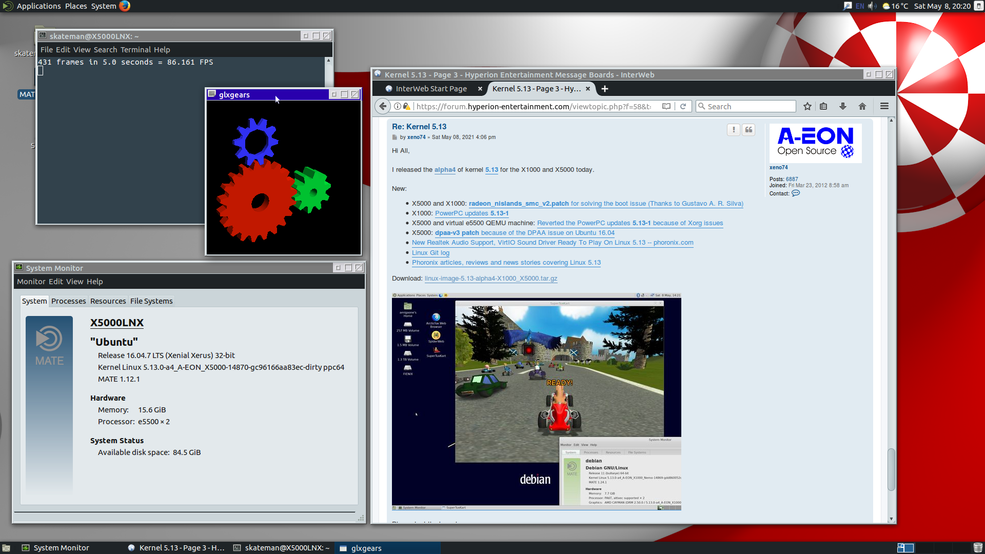

Posts: 968
Re: Kernel 5.13
Kernel 5.13 Alpha4 is running fine on my AmigaOne X5000
Big picture http://www.skateman.nl/wp-content/uploa ... 202028.png
Posts: 11102
Re: Kernel 5.13
Skateman wrote: Sat May 08, 2021 8:21 pm Kernel 5.13 Alpha4 is running fine on my AmigaOne X5000
Thank you for testing the alpha4! :-)
