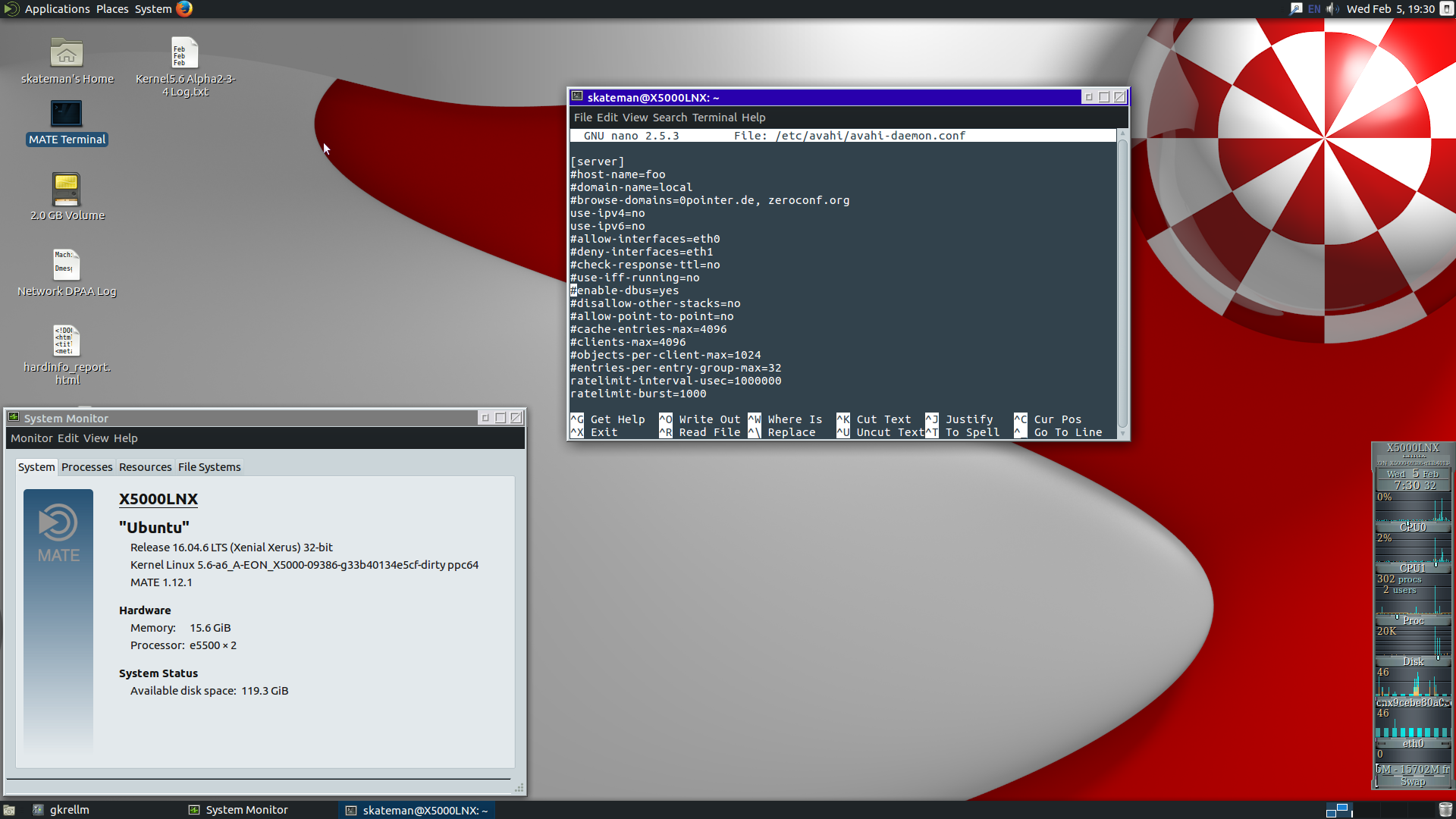

Kernel 5.6 Alpha6 up and running on the AmigaOne X5000
Big picture http://www.skateman.nl/wp-content/uploa ... 193032.png
I have set the IPv4 and IPv6 values to NO in the avahi conf file and the high cpu issue is gone (which makes sense when both ipv4 and ipv6 are left alone)
Posts: 11542
Re: Kernel 5.6
Skateman wrote: Wed Feb 05, 2020 7:35 pm Kernel 5.6 Alpha6 up and running on the AmigaOne X5000
Thanks a lot for testing the alpha6! :)
