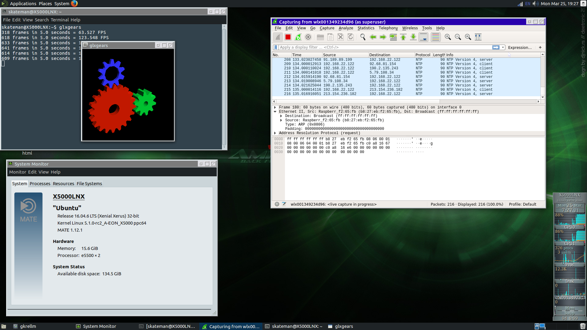

Posts: 977
Re: Kernel 5.1
Kernel 5.1 RC2 running fine on the AmigaOne X5000
Big picture http://www.skateman.nl/wp-content/uploa ... 192721.png
Posts: 11372
Re: Kernel 5.1
Skateman wrote:Kernel 5.1 RC2 running fine on the AmigaOne X5000
Thanks a lot for testing the RC2! :-)

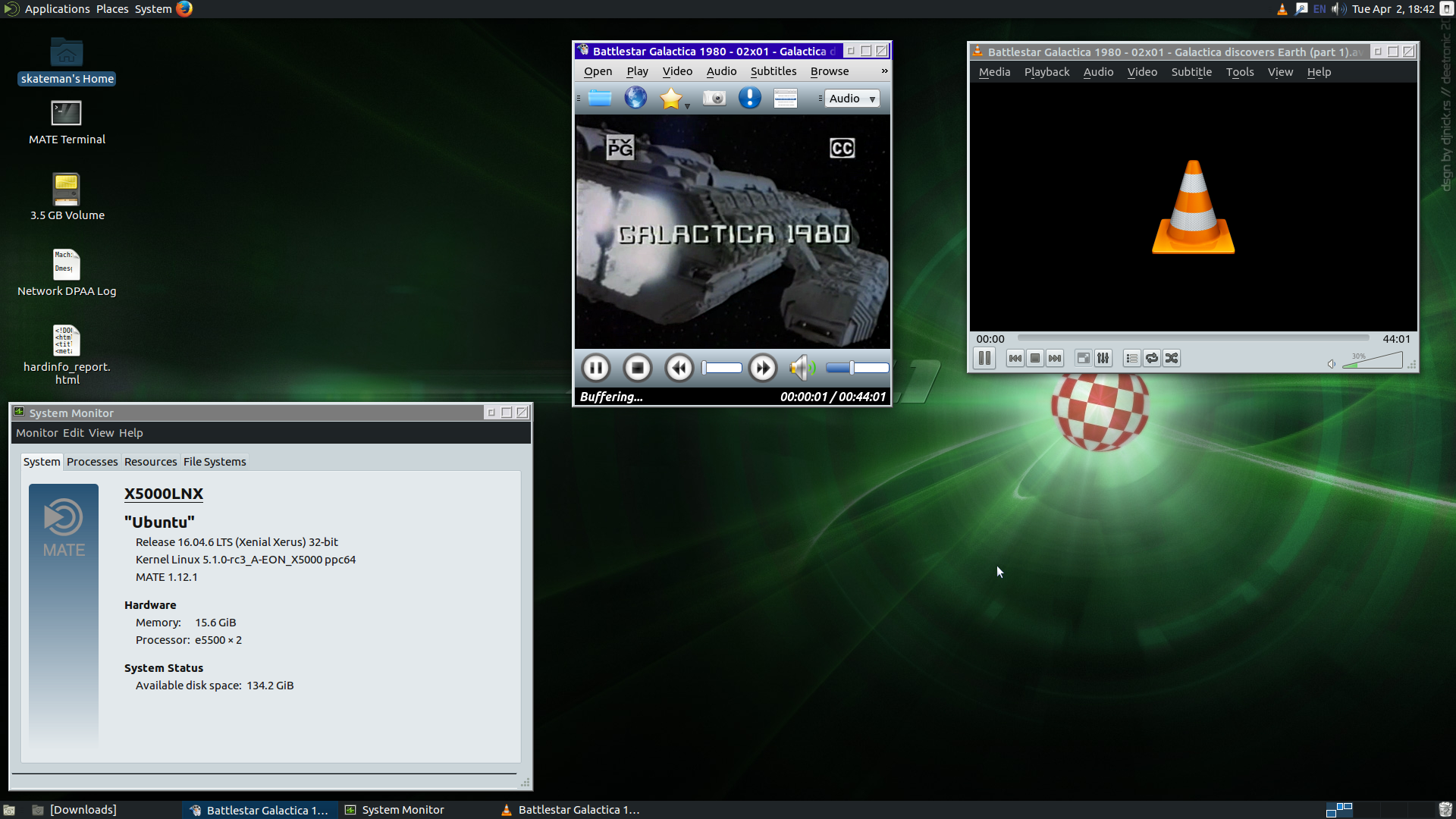

Posts: 11372
Re: Kernel 5.1
Here is the RC3 of kernel 5.1 for testing.
Issues:
I figured out, that the VLC player doesn't play videos anymore since the RC2 of kernel 5.1. VLC plays videos with the RC1 of kernel 5.1 without any problems. The issue is between the RC1 and the RC2.
I tested the VLC 3.0.4 on Fienix and VLC 2.2.2 on ubuntu MATE 16.04.6 LTS.
Please test the VLC and ViewTube with the RC3 of kernel 5.1.
Download: linux-image-5.1-rc3-X1000_X5000.tar.gz
Screenshot of Fienix PowerPC with Compiz and with the RC3 of kernel 5.1:

Posts: 977
Re: Kernel 5.1
RC3 SMtube playing video files without problem. VLC not working.. or showing first frame of video and stalls.
Big Picture http://www.skateman.nl/wp-content/uploa ... 164349.png
