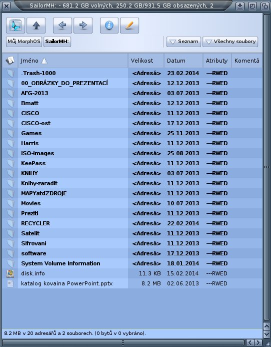

Hello, I have also one strange thing with ntfs3g and usb 1TB disk (Seagate FreeAgent GoFlex, with one NTFS (MBR) partition):
-when I insert disk into usb, it is correctly recognized, but I see only part of files (see pic1) .. both on Pegasos/AmigaOS and AmigaOneX1000/AmigaOS
Pic1

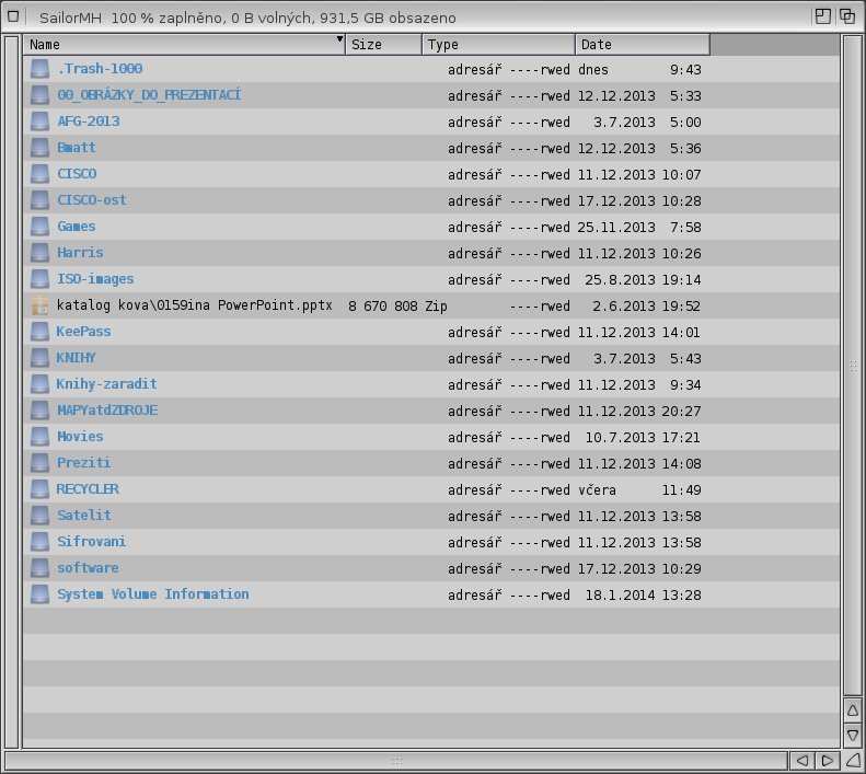

-when I try it on Pegasos/MorphOS, I see all files correctly (pic2), same as under linux
Pic2
Pic2
-when I dismount it (tried on AmigaOneX1000/AmigaOS) and mount it manually with created mountlist and old ntfs0.9 from Aminet, I see all files (pic3)
Pic3
(108.95 KiB) Downloaded 97 times
Do you have any idea what is wrong ?
Note: The files visible under AmigaOS ntfs3G are first ones in alphabetical order.

fbx: FbxLockEntry: lock 0x59ab6018
fbx: FSLock => r1: 0x59ab6018 r2: 0
fbx: FSDupLock(0x5d987340, 0x618a7864, 0x59ab6018)
fbx: FbxDupLock(0x59ab6018)
fbx: FbxLockEntry(0x597ed720, 0x5dd06ae8, -2)
fbx: FbxLockEntry: lock 0x59ab6088
fbx: FSLock => r1: 0x59ab6088 r2: 0
fbx: FSParentDir(0x5d987340, 0x618a7864, 0x59ab6088)
fbx: FbxLocateParent(0x59ab6088)
fbx: FSParentDir => r1: 0x0 r2: 0
fbx: FSUnLock(0x5d987340, 0x5f932cb0, 0x59ab6088)
fbx: FbxUnLockObject(0x59ab6088)
fbx: FbxEndLock(0x597ed720, 0x59ab6088)
fbx: FbxCleanupEntry(0x597ed720, 0x5dd06ae8)
fbx: FbxCleanupEntry: path '/'
fbx: FSUnLock => r1: -1 r2: 0
fbx: FSUnLock(0x5d987340, 0x5f932d60, 0x59ab6018)
fbx: FbxUnLockObject(0x59ab6018)
fbx: FbxEndLock(0x597ed720, 0x59ab6018)
fbx: FbxCleanupEntry: freed entry 0x5dd06ae8
fbx: FbxFlushAll(0x597ed720)
fbx: Fbx_fsync(0x597ed720, '', 0, 0x0)
fbx: FSDeviceInfoData(0x5d987340, 0x618a7864, 0x5f8d17a0)
fbx: FbxDiskInfo(0x597ed720, 0x5f8d17a0)
fbx: Fbx_statfs(0x597ed720, '', 0x5f932be8)
fbx: FSDeviceInfoData => r1: -1 r2: 0
fbx: FSLock(0x5d987340, 0x602892d4, 0x0, '', -2)
fbx: FbxLocateObject(0x0, '', -2)
fbx: FbxLockName2Path(0x0, '', 0x597ed974)
fbx: FbxLockName2Path: DONE => '/'
fbx: FbxPathToFS(0x597ed720, '/', 0x597edd74)
fbx: FbxPathToFS: '/'
fbx: Fbx_getattr(0x597ed720, '/', 0x595a1d78)
fbx: FbxFindEntry(0x597ed720, '/')
fbx: FbxHashPath(0x597ed720, '/')
fbx: FbxHashPathCase(0x597ed720, '/')
fbx: FbxSetupEntry(0x597ed720, '/', 2, 0x5)
fbx: FbxPathToFS(0x597ed720, '/', 0x5dd06ef0)
fbx: FbxAddEntry(0x597ed720, 0x5dd06ae8)
fbx: FbxHandlePackets(0x597ed720)
fbx: FSExamineLock(0x5d987340, 0x595a1dd0, 0x59ab6018)
fbx: FbxExamineLock(0x597ed720, 0x59ab6018)
fbx: Fbx_getattr(0x597ed720, '/', 0x595a1d30)
fbx: FSExamineLock => r1: 0x60415680 r2: 0
fbx: FSDeviceInfoData(0x5d987340, 0x595a1d90, 0x5ff60130)
fbx: FbxDiskInfo(0x597ed720, 0x5ff60130)
fbx: Fbx_statfs(0x597ed720, '', 0x595a1d18)
fbx: FSDupLock(0x5d987340, 0x602892d4, 0x59ab6018)
fbx: FSLock(0x5d987340, 0x602892d4, 0x59ab6088, '', -2)
fbx: FbxLocateObject(0x59ab6088, '', -2)
fbx: FbxLockName2Path(0x59ab6088, '', 0x597ed974)
fbx: Fbx_getattr(0x597ed720, '/', 0x595a1b98)
fbx: FbxLockEntry: lock 0x59ab60f8
fbx: FSLock => r1: 0x59ab60f8 r2: 0
fbx: FSUnLock(0x5d987340, 0x595a1bd0, 0x59ab6088)
fbx: FSExamineLock(0x5d987340, 0x595a1c40, 0x59ab60f8)
fbx: FbxExamineLock(0x597ed720, 0x59ab60f8)
fbx: Fbx_getattr(0x597ed720, '/', 0x595a1ba0)
fbx: FSDeviceInfoData(0x5d987340, 0x595a1c00, 0x5ff60130)
fbx: Fbx_statfs(0x597ed720, '', 0x595a1b88)
fbx: FSExamineDir(0x5d987340, 0x595a1c50, 0x60415680)
fbx: FbxExamineDir(0x597ed720, 0x60415680)
fbx: Fbx_readdir(0x597ed720, '/', 0x60415680, 0x7f7e1a4c, 0, 0x0)
fbx: FbxFSToPath(0x597ed720, 'Games', 0x597ed974)
fbx: FbxFSToPath: 'Games'
fbx: FbxFSToPath(0x597ed720, '00_OBRÁZKY_DO_PREZENTACÍ', 0x597ed974)
fbx: FbxFSToPath: '00_OBRÁZKY_DO_PREZENTACÍ'
fbx: FbxFSToPath(0x597ed720, 'AFG-2013', 0x597ed974)
fbx: FbxFSToPath: 'AFG-2013'
fbx: FbxFSToPath(0x597ed720, 'Bmatt', 0x597ed974)
fbx: FbxFSToPath: 'Bmatt'
fbx: FbxFSToPath(0x597ed720, 'CISCO', 0x597ed974)
fbx: FbxFSToPath: 'CISCO'
fbx: FbxFSToPath(0x597ed720, 'CISCO-ost', 0x597ed974)
fbx: FbxFSToPath: 'CISCO-ost'
fbx: FbxFSToPath(0x597ed720, 'Harris', 0x597ed974)
fbx: FbxFSToPath: 'Harris'
fbx: FbxFSToPath(0x597ed720, 'ISO-images', 0x597ed974)
fbx: FbxFSToPath: 'ISO-images'
fbx: FbxFSToPath(0x597ed720, 'katalog kovařina PowerPoint.pptx', 0x597ed974)
fbx: FbxFSToPath: 'katalog kova?ina PowerPoint.pptx'
fbx: FbxFSToPath(0x597ed720, 'KeePass', 0x597ed974)
fbx: FbxFSToPath: 'KeePass'
fbx: FbxFSToPath(0x597ed720, 'KNIHY', 0x597ed974)
fbx: FbxFSToPath: 'KNIHY'
fbx: FbxFSToPath(0x597ed720, 'Knihy-zaradit', 0x597ed974)
fbx: FbxFSToPath: 'Knihy-zaradit'
fbx: FbxFSToPath(0x597ed720, 'MAPYatdZDROJE', 0x597ed974)
fbx: FbxFSToPath: 'MAPYatdZDROJE'
fbx: FbxFSToPath(0x597ed720, 'Movies', 0x597ed974)
fbx: FbxFSToPath: 'Movies'
fbx: FbxFSToPath(0x597ed720, 'Preziti', 0x597ed974)
fbx: FbxFSToPath: 'Preziti'
fbx: FbxFSToPath(0x597ed720, 'RECYCLER', 0x597ed974)
fbx: FbxFSToPath: 'RECYCLER'
fbx: FbxFSToPath(0x597ed720, 'Satelit', 0x597ed974)
fbx: FbxFSToPath: 'Satelit'
fbx: FbxFSToPath(0x597ed720, 'Sifrovani', 0x597ed974)
fbx: FbxFSToPath: 'Sifrovani'
fbx: FbxFSToPath(0x597ed720, 'software', 0x597ed974)
fbx: FbxFSToPath: 'software'
fbx: FbxFSToPath(0x597ed720, 'System Volume Information', 0x597ed974)
fbx: FbxFSToPath: 'System Volume Information'
fbx: FbxLockName2Path(0x59ab60f8, 'Games', 0x597ed974)
fbx: FbxLockName2Path: DONE => '/Games'
fbx: FbxPathToFS(0x597ed720, '/Games', 0x597edd74)
fbx: FbxPathToFS: '/Games'
fbx: Fbx_getattr(0x597ed720, '/Games', 0x595a1b60)
fbx: FbxLockName2Path(0x59ab60f8, '00_OBRÁZKY_DO_PREZENTACÍ', 0x597ed974)
fbx: FbxLockName2Path: DONE => '/00_OBRÁZKY_DO_PREZENTACÍ'
fbx: FbxPathToFS(0x597ed720, '/00_OBRÁZKY_DO_PREZENTACÍ', 0x597edd74)
fbx: FbxPathToFS: '/00_OBRÁZKY_DO_PREZENTACÍ'
fbx: Fbx_getattr(0x597ed720, '/00_OBRÁZKY_DO_PREZENTACÍ', 0x595a1b60)
fbx: FbxLockName2Path(0x59ab60f8, 'AFG-2013', 0x597ed974)
fbx: FbxLockName2Path: DONE => '/AFG-2013'
fbx: FbxPathToFS(0x597ed720, '/AFG-2013', 0x597edd74)
fbx: FbxPathToFS: '/AFG-2013'
fbx: Fbx_getattr(0x597ed720, '/AFG-2013', 0x595a1b60)
fbx: FbxLockName2Path(0x59ab60f8, 'Bmatt', 0x597ed974)
fbx: FbxLockName2Path: DONE => '/Bmatt'
fbx: FbxPathToFS(0x597ed720, '/Bmatt', 0x597edd74)
fbx: FbxPathToFS: '/Bmatt'
fbx: Fbx_getattr(0x597ed720, '/Bmatt', 0x595a1b60)
fbx: FbxLockName2Path(0x59ab60f8, 'CISCO', 0x597ed974)
fbx: FbxLockName2Path: DONE => '/CISCO'
fbx: FbxPathToFS(0x597ed720, '/CISCO', 0x597edd74)
fbx: FbxPathToFS: '/CISCO'
fbx: Fbx_getattr(0x597ed720, '/CISCO', 0x595a1b60)
fbx: FbxLockName2Path(0x59ab60f8, 'CISCO-ost', 0x597ed974)
fbx: FbxLockName2Path: DONE => '/CISCO-ost'
fbx: FbxPathToFS(0x597ed720, '/CISCO-ost', 0x597edd74)
fbx: FbxPathToFS: '/CISCO-ost'
fbx: Fbx_getattr(0x597ed720, '/CISCO-ost', 0x595a1b60)
fbx: FbxLockName2Path(0x59ab60f8, 'Harris', 0x597ed974)
fbx: FbxLockName2Path: DONE => '/Harris'
fbx: FbxPathToFS(0x597ed720, '/Harris', 0x597edd74)
fbx: FbxPathToFS: '/Harris'
fbx: Fbx_getattr(0x597ed720, '/Harris', 0x595a1b60)
fbx: FbxLockName2Path(0x59ab60f8, 'ISO-images', 0x597ed974)
fbx: FbxLockName2Path: DONE => '/ISO-images'
fbx: FbxPathToFS(0x597ed720, '/ISO-images', 0x597edd74)
fbx: FbxPathToFS: '/ISO-images'
fbx: Fbx_getattr(0x597ed720, '/ISO-images', 0x595a1b60)
fbx: FbxLockName2Path(0x59ab60f8, 'katalog kova?ina PowerPoint.pptx', 0x597ed974)
fbx: FbxLockName2Path: DONE => '/katalog kova?ina PowerPoint.pptx'
fbx: FbxPathToFS(0x597ed720, '/katalog kova?ina PowerPoint.pptx', 0x597edd74)
fbx: FbxPathToFS: '/katalog kova?ina PowerPoint.pptx'
fbx: Fbx_getattr(0x597ed720, '/katalog kova?ina PowerPoint.pptx', 0x595a1b60)
fbx: FSExamineDir => r1: 0 r2: 205
fbx: FSDeviceInfoData(0x5d987340, 0x595a1c00, 0x5d903720)
fbx: FbxDiskInfo(0x597ed720, 0x5d903720)
fbx: FSDupLock(0x5d987340, 0x602892d4, 0x59ab60f8)
fbx: FbxDupLock(0x59ab60f8)
fbx: FSExamineDir => r1: 0 r2: 232
fbx: FSUnLock(0x5d987340, 0x595a1c70, 0x59ab60f8)
fbx: FbxUnLockObject(0x59ab60f8)
fbx: FbxEndLock(0x597ed720, 0x59ab60f8)
fbx: FSUnLock(0x5d987340, 0x595a1d10, 0x59ab6088)
fbx: FSUnLock(0x5d987340, 0x595a1eb0, 0x59ab6018)

hmm, it seems (in sashimi output) that filesysbox read all files.. But I see only files upto "k"..
maybe it is sometning with Czech filenames ? there is file "katalog kovařina PowerPoint.pptx" on disk and after this is no files are visible on list..

sailorMH wrote:hmm, it seems (in sashimi output) that filesysbox read all files.. But I see only files upto "k"..
The problem is the ř character which doesn't have an equivalent in the ISO-8859-15 character set. I could easily get filesysbox.library to display all the other files by having the ExamineDir() code continue after this kind of error instead of simply stopping but I'd rather have a better solution than that.

For sure this error is caused by czech letters. When I rename this file to ascii-128 name, in root directory I see all files.
Of course, in sub-dirs with czech names only part of files...
And in Morphos output ( pic2 several posts before) there is listed name with czech character missing.
The MorphOS "solution" seems a bit strange. Can you still access that file normally with czech character missing? What happens if you already have a file with the same name except that this character is missing?
The NTFS 0.9 solution of converting the non-representable character into a backslash followed by the hexadecimal represention of the UTF-8 character seem so bad at least from an implementation standpoint. Unfortunately going that way I will probably have to use something else than iconv() for the character set conversion...
