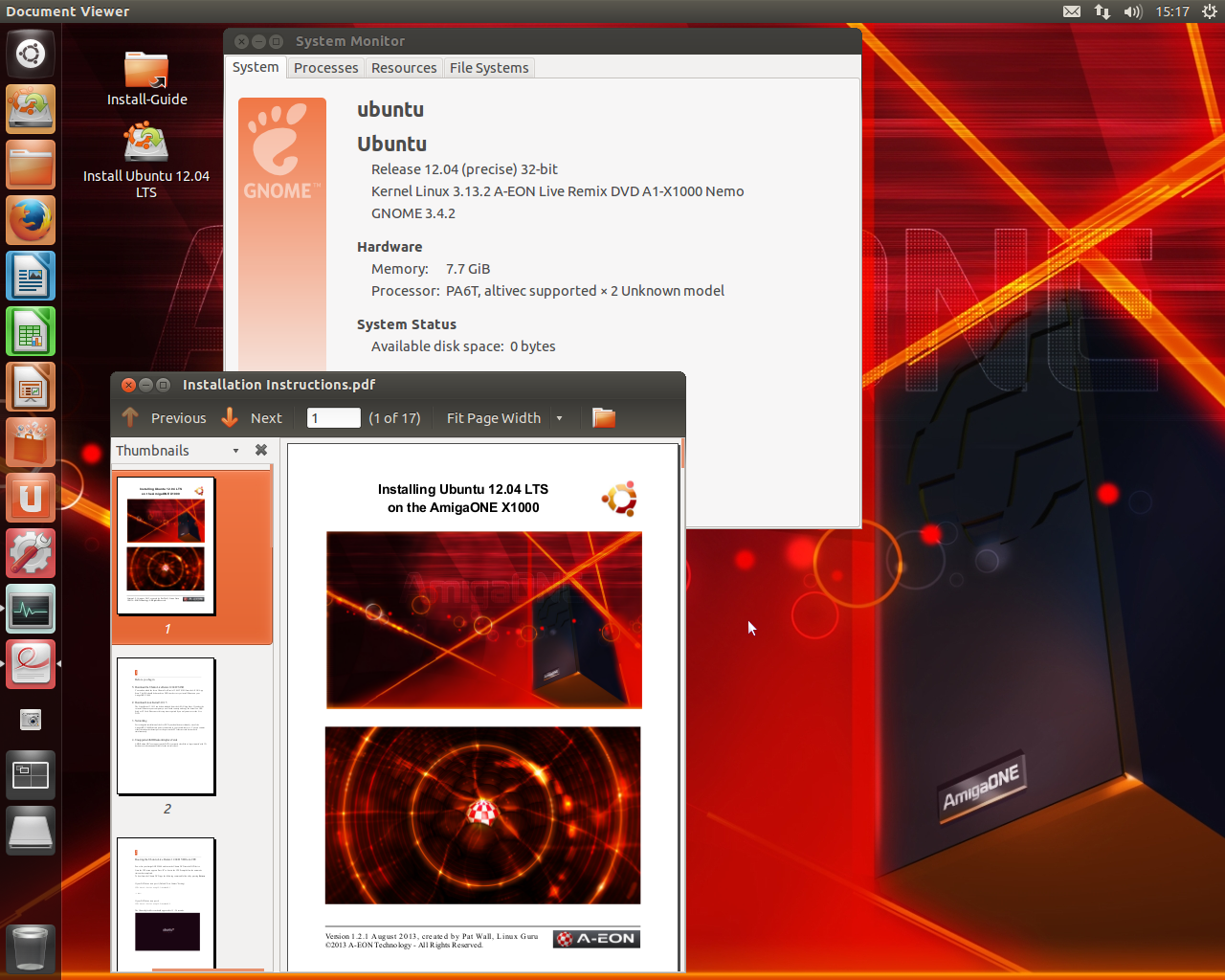

The new Ubuntu kernel 3.13.2 for the Live Remix DVD is coming. :-)
